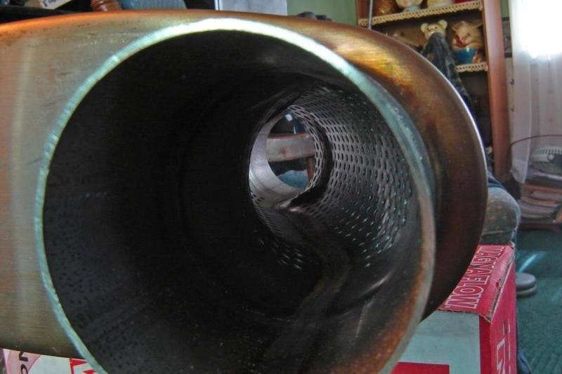

It has rasp to it even with a magnaflow muffler, but why? I don't believe it is the muffler causing it, what else could it be?

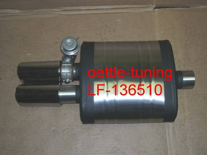

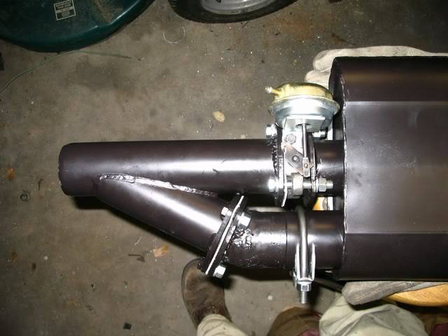

Or you could do this...same result whether before or after a two chamber muffler but the one with the valve on the inlet will be be more quiet than the one with the valve on the outlet because of possible sealing issues.
This is why so many people find magnaflow "straight through"mufflers a bit loud.
Generally a Humhotlz resonator is used to reduce drone. J-pipes and side chambers are both examples that are used to very good results. As a general rule. the High pitch sounds that lend raspiness are carried in a straight line or reflect well down the inside of the pipe. The low end sounds carry well in reversals due to the pressure wave component being so pronounced. You did quite well in looking to a magnaflow. Keep in mind that anything straight will carry some of that edge. A reversing or V gate type muffler will usually scrub most of the highs off. Some of this style have a pressure activated gate internal so that they reduce back pressure at Wide Open Throttle.
You may also want to look at a Flowmasters series. They have V gate types in the more family end and in a pro series have a packed Delta that has a much deeper tone. It is still pretty good at removing the highs even though straight due to the delta configuration. There are a few good video clips available but none I know of that actually feature subaru's
