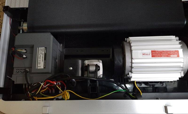

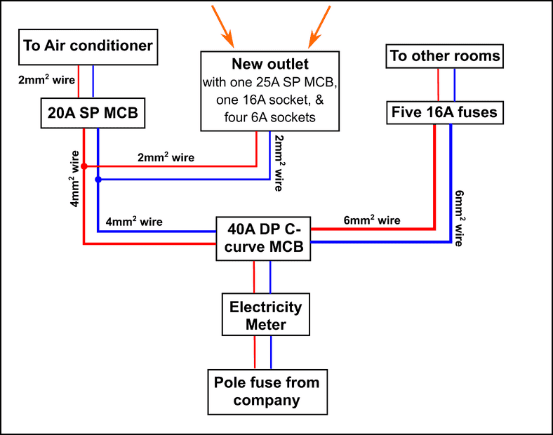

We bought a 4HP semi-commercial treadmill that requires a 16A outlet. Our mains are 230V RMS @ 50Hz. Just got the electricians to install a new set of wires from the ground up. The new outlet box that I bought on Amazon came with a 25A SP MCB, one 16A outlet, and four 6A outlets. The circuit is like this at the moment:
Here's the issue: When I am switching the treadmill on and increasing the speed, I can hear a shrill sound. A pretty high-pitched shrill sound. As I increase the speed (max speed is 22km/h at 6HP), the noise becomes really loud. I mean, concerning loud. And I am 100% sure that it is coming from the MCB in this outlet box because yesterday I tested the treadmill using a separate 16A extension outlet that has a fuse, and there was no such sound. I tested this new outlet box at normal running speed, and it was fine. My bad, I should have tested this too at full power.
I can ask the electrician to bypass that MCB and connect to the 20A SP MCB. That's fine. But is there anything I can check to make sure that the sound is indeed coming from this MCB? I am really disappointed because now I can't return this thing as holes have already been drilled.

The treadmill probably uses a DC servo motor. The AC supply is rectified, then PWM by an H-bridge, to control the motor. You are somehow hearing magnetostriction, as the PWM current passes through some iron core inductor, in the MCB, but more probably the motor.
This treadmill came with an AC motor.
Also, if it is magnetostriction, I believe I should've heard the sound for the past three days too?
Then, how is the speed changed?
What mechanism is used by the MCB? Could the MCB be responding to the motor controller, or a power factor controller?

I expect your MCB has a bimetallic thermal trip for detecting overcurrent, and an electromagnetic trip for sudden short circuits. You may be hearing the electromagnet responding to the high frequency current drawn by the variable frequency motor controller. I would put a low-pass noise filter in the line from the MCB to the treadmill, to see if it changes the sound.
Could it be an earthing issue? I just measured neutral vs PE, it's coming to be 4.87V, unlike last time, where it was 0.3V. Live vs neutral and live vs PE has a difference of around that same value.
Maybe the electricians messed it up somewhere?

Maybe the lack of a PE on the treadmill circuit is preventing the noise filter on the treadmill motor controller from functioning. Maybe a connector clamp has not been tightened, so there is a current sensitive spark gap in the AC supply circuit.
Chasing AC voltages with a high impedance multimeter will only lead you astray. Instead, try plugging in a 240 volt, 100 watt filament lamp, or an electric water heater on the same circuit. As that will change the RF impedance of the local wires, if the noise is travelling electrically over the wires, changing the impedance and load point, will change the character of the noise.

Too much IMO. But that assumes it's 50/60Hz. Some meters may also be measuring the higher frequency noise that you are hearing. Try it with an incandescent light bulb or heater element, they don't (shouldn't) make electrical noise.
One potential cause is bad connections in the neutral wiring (too much resistance). You could also try measuring the resistance WITH EVERYTHING TURNED OFF from the PE to another ground (a water pipe, another outlet). Also from an unloaded neutral to various PEs and grounds. Do it carefully. Measure voltage first and verify it's zero so you don't kill your meter or yourself. Even 5V could hurt your meter, or at least give you bad data. Swapping hot and neutral isn't an uncommon error in careless wiring.
You might also be able to trace the voltage drop upstream to see where it goes bad if you know the wiring well enough to find upstream outlets and such.

Here's the thing: as I said, we could not reproduce the 4.87V PD between PE and neutral. However, it seems that the MCB is not at fault after all. We connected it to a fuse circuit that does not have an MCB (except the 40A DP), and the sound was still there. So I opened the casing of the treadmill and started the motor in that situation. Seems it is coming from the motor controller (the middle one in the picture below).
But you know what's worse? The treadmill was rated at 3HP normal and 6HP peak. Upon opening, the motor is rated at 1.5HP normal and 3.5HP peak. So I was just scammed.
