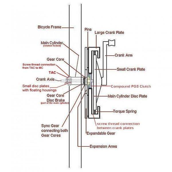

  • Cross-section diagram of an expandable gear CVT hub: bicycle frame, main cylinder, gear core, crank arm, crank plates, compound PGS clutch, torque spring, expandable gear and expansion arms, with labels as shown.

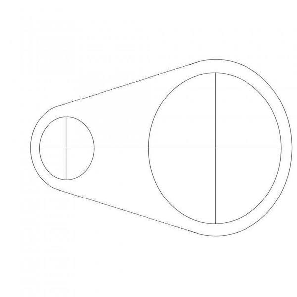

  • Line drawing of two circles joined by tangent lines, forming a stadium-like outline, with a small circle on the left and a large circle on the right, each marked with a horizontal and vertical centreline.

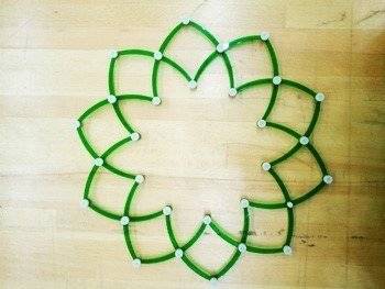

  • Green flexible strips arranged in a radial flower-like pattern on a wooden surface, held at their ends by white round pivot pins, with the strips crossing and looping around a central ring of pins.

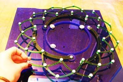

  • Photo of a prototype mechanism on a purple base: a ring of green linkage arms joined by white pivot pins around a central blue gear, with a hand at the left edge.

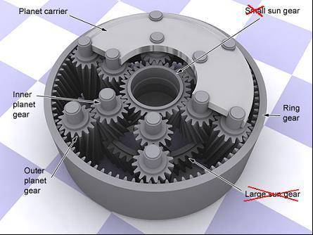

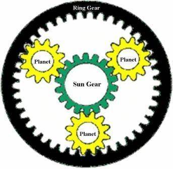

  • Diagram of a planetary gear set: a central green sun gear meshed with three yellow planet gears, all enclosed by a black ring gear with internal teeth.
  • Rendered 3D model of a planetary gear set with a planet carrier, inner and outer planet gears, a ring gear, and a large sun gear crossed out in red, with a small sun gear also crossed out.
Cool. It looks like you've done some prototyping -- have you fit a prototype on your bicycle? :smile:
This is very interesting, have you ever considered fitting the mechanism inside of a hub shell where the rear cog would be the one that expands/contracts?
@berkeman - unfortunately I haven't yet made any prototypes, having some rapid-prototypes from a 3D CAD model would be very helpful, and I have Autocad software, I just haven't had the time to sit down and make the models.
@louie13 - thank you, I'm thinking the whole setup would probably work best in an enclosure of some type, to protect the large number of moving mechanical parts and to make the setup more stable. The problem with only having one cog expand/contract is that the chain isn't elastic, and so wouldn't allow for expansion, or would fall off under contraction, unless springs are used like in typical multi-speed transmissions. When 2 cogs are used, inversely correlated, then the chain can maintain the same fixed size, maintaining that nice high torque conversion I'm looking for.

Single front and rear gears that both expand and contract (using looped scissor-like radial expansion segments, Hoberman), inversely correlated (as one expands the other contracts), duplicating the effect of popular cone shaped variable transmissions, but with the high torque to speed conversion efficiency of a single front and rear gear setup.

Gear Contraction (front gear, on crank):
This will happen when the expanding circle (Hoberman) gear is held rotationally still, and the gear core in rotated. When the gear core is rotated, the curved expansion arms will rotate and move from a horizontal position to a vertical position; pulling in the expansion arms; contacting the expandable gear.
Rotating the gear cores in relation to the expanding gears will be accomplished with a clutch plate attached to a disc hard attached to the crank axis. This clutch plate, along with the crank axis, is moved inwards to connect with the gear core by way of an inner crank plate moving along screw threads into an outer crank plate.
Gear Expansion (front gear, on crank):
This will happen when the gear core is rotated in reverse. This will be accomplished with a planetary gear setup on the crank axis, on the opposite side of the gear core than the expansion clutch. The outer ring gear will be hard attached to a plate, hard attached to the crank axis. The inner sun gear will be loosely attached (oil or bearings) to the crank axis, and would have a clutch plate attached to it, to make connection with the other side of the gear core. The middle planet gears will spin on pins hard attached to the plate that the outer ring gear is hard attached to, and would be held in place with pin heads or by enclosing the planetary gear setup (minus the sun gear clutch connecting surface).

- Drive Chain:
The inner most rotation points of the expanding circle (Hoberman) have the greatest ratio of expansion, and so the drive chain would need to be expanded/contacted based on their movement. For the drive chain to be expanded/contacted along with the circle, the rotation points would need to have expanded pins (out towards the crank plate), long enough to support the width of the drive chain, with freely spinning cylinders on which the drive chain would rest and move along like a conveyer belt.
The drive chain will have the gear "teeth", which will protrude horizontally, towards and connecting with the crank plate and the rear axle plate, which will have radial grooves that the teeth connect with. The teeth would connect in unison with the rotation of the crank plate on one half of it, but the issue would be the other half, where the chain and teeth would cause friction against the rotating crank; moving somewhat perpendicular to the rotational direction of the plate. To solve this, the "teeth" need to be able to swivel horizontally out, and then back inside the chain; so that they can come in frictional contact with the crank plate only on the one half where it is helpful. This could be done with chain "guides", one that will brush the back of the teeth causing them to open up outward just after the half way point, and then another guide to push them back into place at the other half point. This would be the same connection type on the rear axle plate.

The automatic transmission will be accomplished with a spring (*this could also be accomplished by filling the space between the two crank plates with compressible fluid or gas, which would be compressed when the inner plate screws inward, and would “spring” back when the torque pressure goes down). The spring will automatically expand or contract the gears, based on the torque needed to move the bicycle. This will cause the level of torque needed to move the bicycle to even out to an average-constant.
The crank arm will attach to a smaller, inset crank plate, nested in the larger crank plate, the spring connecting the two plates together, vertically. When torque is applied, the inner crank plate will start winding the spring. If low toque is needed to rotate the rear wheel axle, then the spring will wind a smaller amount before the outer crank plate/drive belt/rear axle starts to rotate, if more torque is needed (i.e. going up hill), then the spring will wind up more beforehand.
The smaller crank plate will have a hard connected protrusion (lock pin) on its vertical outer edge, which will lock it against the vertical inner edge of the larger crank plate, at the starting (0% torque) position. This will prevent the spring from pulling the crank plates into a negative torque position.
The relative difference in rotation of the smaller and larger crank plates will be translates into movement of the crank axis in and out of the bicycle frame. This will be accomplished by having screw threads connecting the small and large crank plates. As increased torque causes more relative difference in rotation between the crank plates, the smaller crank plate will begin to rotate on screw threads between its outer edge and the inner edge of the large crank plate; moving the small crank plate inward. As the small crank plate will be hard connected to the crank axis; as the crank plate moves inward, so too does the crank axis.
As torque starts at a low percentage, the planetary gear clutch will start off being connected, causing front expandable gear expansion. As torque increases to mid-range the crank axis will move and disengage the inner planetary gear core clutch, stopping expandable gear expansion and maintaining it. As torque increases to a high level, the crank axis will move in enough to engage the outer front gear core clutch, causing front expandable gear contraction.
Torque adjustment would be accomplished by “winding” or unwinding the spring.

So... I just realized a major issue with the drive chain. In order to allow for expansion/contraction, the chain needs to have one-way friction along the contact points; to allow the contact points to move back along the belt. BUT, I wasn't thinking about how the rear gear contacts would need to be in reverse! Instead of being pushed, they are doing the pushing.
I had originally tried out the idea of an elastic or spring connected drive chain, that could flex to support the expansion, but the issue is that these points would also flex while applying torque to the belt to move the crank, so you would want it pretty tight, but then you need it to be pretty loose so that it doesn't take a lot of force to expand the contact points during expansion.
So, I suppose I might need a double sided chain or belt, that has opposite direction one-way friction connection points on either side. The issue there is that then the rear gear connection would have to be on the inside of the contact points on the gear, which would be difficult, or... the chain could be twisted? Twice, one between each change over between gears.
Or, there are one-way hinged-door type chain connectors (with small springs inside to keep them up until expansion occurred) having a sliding switch on the side of the chain so that when slid forward or back they would allow or prevent the door from swinging one way or the other, with some mechanism to switch the slide lock on each, two times, as they pass between each gear.
