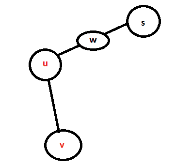

I have understood that $\delta(s,v)$ is the shortest path from the vertex $u$ to the vertex $v$ and $\delta(s,u)$ is the shortest path from the vertex $s$ to the vertex $u$..But..can we only have a graph like the following:

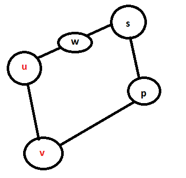

or is it also possible that there are,for example, two or more ways from $s$ to $v$ and therefore,that we have cycles? (Thinking)
For example,could we have something like that?
Yes, we can have such graph. Note that $\delta(s,v)=3$ and $\delta(s,u)=2$, so $\delta(s,v)\le\delta(s,u)+1$, as required. It does not matter if there are one or several paths from $s$ to $v$.
Yes, this graph is also possible. Here $\delta(s,v)=2$ and $\delta(s,u)=2$, so again $\delta(s,v)\le\delta(s,u)+1$. In general, $\delta(s,u)=n$ means, in particular, that there exists a path $p$ from $s$ to $u$ of length $n$. Also, the condition $(u,v) \in E$ means that there is an edge from $u$ to $v$. If we add $v$ to $p$, we get a path of length $n+1$ from $s$ to $v$. Now, this new path may not be the shortest one, as in your second example, but in any case the shortest path from $s$ to $v$ must not be longer than $n+1$ (the length of some path).
To be pedantic, we need to check whether the definition of a path allows repeated vertices. Wikipedia says that most authors require that all vertices in a path must be distinct. Vertices can be repeated in a walk, which is a more general concept. If so, then adding $v$ to $p$ above may not produce a path if $v$ is already present in $p$. However, then the shortest path from $s$ to $v$ does not exceed $n$, so $\delta(s,v)\le n+1$ holds.
