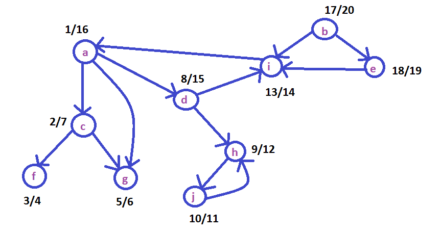

I want to apply the Depth-first search algorithm at the following graph.
We consider that at the iteration of the algorithm, we look at the nodes alphabetically. Also the nodes are registered alphabetically in each list. I want to calculate the "discovery" time and the "finish" time for each node and also the kind of each edge.

I found these "discovery" and "finish" times:
Have I calculated them right? (Thinking)

I think that it should be like that:
View attachment 3669But how can we find the type of the edges? :confused:

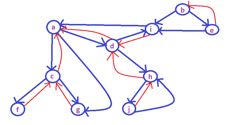

This graph:
View attachment 3678shows the parent of each node.
When there is a red edge does this mean that we have a tree edge? If so, could you explain me why? (Thinking)
Aren't $jh,ia$ forward edges and $ag$ a back edge? (Thinking)
