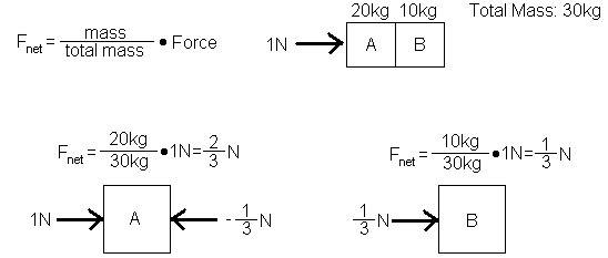

Given two boxes which are sitting directly next to each other, and a force applied to the leftmost box in the rightward direction (straight at the other box), are there any rules/formulas for the amount of force which the leftmost box applies to the box it is sitting next to?
Example:
What causes the 1N force being applied to A to be smaller when A applies it to B?
I have a vague theory that it has something to do with A "absorbing" some of the force due to its mass, but I haven't been able to get any further with this.
As you can see, I can actually calculate what these values are, but the problem is that I don't understand why they are the way they are. It seems to me that if a 1N force is being applied in a rightward direction on A, then A would apply a 1N rightward force on the block to its right, which is B. However, this doesn't seem to be the case, at least not when viewed like this.
I tried attacking this with the assumption that a 1N force is actually being applied to B, but is being partially counteracted somewhere. I didn't get very far with this approach either.
I think I simply need someone to explain how this works, step by step.

Although the magnitude and direction of the forces shown in your FBD's are correct, you should show them on the sides on which they act. It may be helpful to see what is happening . On Block A, the 1 N acts on the left side of the block and points right toward the block; the 1/3 N acts on the right side of the block and points left toward the block. Then on block B, per Newton 3, the 1/3 N force acts on the left side, pointing right, toward the block, and there is no force on the right side. You still get the same net force, but with a better picture. Beyond that, as 6Stang7 has noted, the 1 N force accelerates all 4 blocks, per F_net = 30a (Newton 2). Since each block has the same acceleration as the entire system of blocks, then again using F_net = ma for each block, F_net on each block must be less.

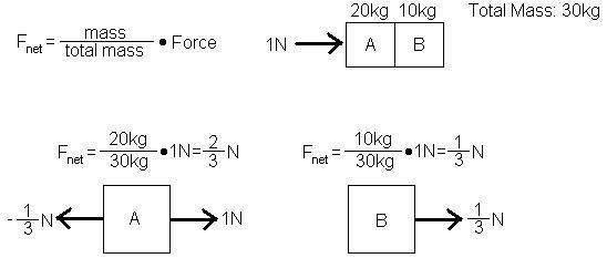

Here is the new version of the example:
Thanks for the tip, I'll probably use this method from now on.
However, the main issue still stands: Exactly what is causing A to apply a smaller force on B? As I said in a previous post, A doesn't care if B accelerates too far. Something must be preventing A from applying the full 1N of force to B... This is where my theory about A "absorbing" some of the force comes from, but that is only a guess and I do not know of any rules to support that theory.

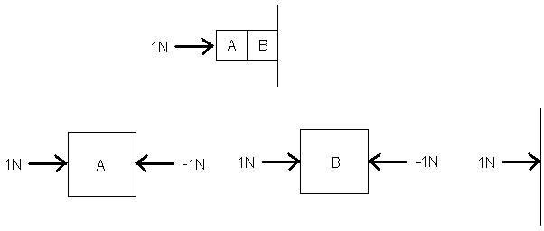

Consider, if you will, those 2 blocks , with the 1 N force applied to the left block, but let's assume this time that block 2 is tight up against a wall. In this case, there is no acceleration, the blocks are at rest, and A does apply the full 1N force to B. In your case, however, there is acceleration, and due to the lower mass (a measure of its resistance to motion) of the individul blocks compared to the combined system of blocks, Newton 2 demands that the net force acting on it must be less (less mass, less resistance to motion, less force required to accelerate it at the same rate).

Hmm, alright let's go with your wall example.
What happens the instant the wall is removed (assuming the wall completely vanishes in an instant)?
Nothing happens in an instant, but assumimg the wall is removed almost instantaneously, then the forces between the blocks reduce almost instantaneously to your original example, and the blocks accelerate, per Newton 2.

If block A (20 kg) would apply tha same 1 N force to block B (10 kg), what force will B exert on A then? According to Newtons third law - 1 N, so the net force on block A is +1N - 1N = 0N, net force on block B then will be 1N. So according to this, you push block A, but it doesn't move at all, instead block B starts to move away. Do you expect this kind of behavior?
