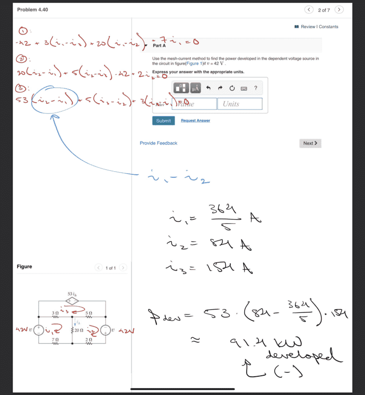

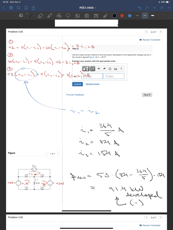

Find the power developed by the dependent voltage source
KVL, KCL
Here's my work.
I have the correct answer, but I'd like to know why this only works for (i1-i2) plugged in for i_delta as opposed to what I initially put: i_delta = i2-i1. You can see this in the blue text above versus what I originally had in red.
Each of the following currents (as they are defined), [itex]i_1, i_2,[/itex] and [itex]i_\Delta[/itex] pass through the [itex]20 \ \Omega[/itex] resistor.
Looking only at a particular current as it passes through the [itex]20 \ \Omega[/itex] resistor,
Is [itex]i_1[/itex] in the same direction as [itex]i_\Delta[/itex], or is it in the opposite direction?
Is [itex]i_2[/itex] in the same direction as [itex]i_\Delta[/itex], or is it in the opposite direction?
Given that, how must you define [itex]i_\Delta[/itex] in terms of [itex]i_1[/itex] and [itex]i_2[/itex]?
Oh... I see now. Basically i_delta's defined direction gives it all away. Thanks for the reply
