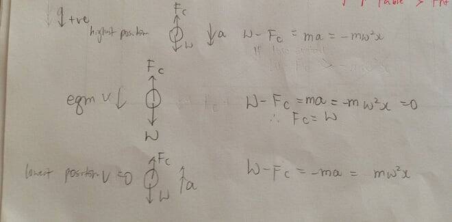

Yes I did!

then show it as attachment so that we can get to your problem

_k8xiwHxV0bG9Qm2Ts8oD_m3dnq_2E2pyOJ2Xu78HfRZMMWe_zcAIIcCDmaJA?width=660&height=326&cropmode=none.jpg

well the attachment fails to open -perhaps a template will be better so that it can easily open.

Can you open it now?

yes, thanks
at some amplitude of oscillations of the cone the sand particles leaves the contact with surface

suppose N is the contact force so N= mg - mw^2.x at any displacement x so when contact force is zero the wt will be balanced by the term on the right hand ;
as i feel mg is down ward so mw^2 .x shoukd be upward.
or think in terms of F(harmonic osc.) = F(Weight) -N
what is wrong in the above picture of forces?

But why I found N-mg = mw^2.x at highest position? if we take upward positive
Because when I use this formula, as x increases, N also increases, instead of becoming zero

in a harmonic oscillation the force which is always a restoring force acts opposite to the displacement
F(osc)= -constantx displacement
if displacement is +ve - force will be negative and just vice-versa
if displacement from mean position is negative then force will be in opposite direction.
will this clarify your picture?

Yes understood thanks!
