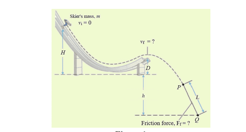

After the skier reaches the ground at point P in Figure 1, she begins braking and comes to a halt at point Q. Find an expression for the magnitude of the constant friction force that acts on her between point P and Q.
W=f*d
I approached the problem using the work done by force equation (W=F*d)
In my understanding all potential energy would have been converted into kinetic energy (KE) by point P (no friciton)
We know d= L ; W= Wf ; f = Ff height = (H+h)
So the Energy at point P is entirely kinetic:
Which translates into: EP= mg(H+h)
because Wf= mg(H+h)
so mg(H+h)= Ffx L
after solving for Ff I get Ff = mg(H+h) / L
My concern is that visually point P still has potential energy. However, the text indicates that this is not the case as the "skier reaches the ground at point P".

Can we see the diagram? Note that the ground, expecially in a ski resort, is not necessarily flat.
Apologies, I forgot to attach the diagram. I have amended my original post
Your expression is correct. You don't have to worry about the intermediate state of kinetic + potential at point P. All that matters is the total change in PE between the start and point Q. (As the skier is at rest - has no KE - at both these points.)

Okay if we think about it that way, is this approach correct:
##Wf = f*d##
Wf = PE = mg(H+h)
f = Ff (friction force)
d = L
so
##mg(H+h) = Ff * L##
solved for Ff =
##Ff = \frac {mg(H+h} {L}## ?

Yes, although it's not necessary always to use ##d## for the distance. In this case, you can simply write:
$$W_f = F_f L$$
Welcome, @Racoon5 !
That equation is incorrectly including an energy that gravity has not given away yet when the skier reaches point P, which is the height differential between points P and Q times mg.
In this case, reaching the ground means commencement of friction action, rather than reaching the height of lowest potential energy.
