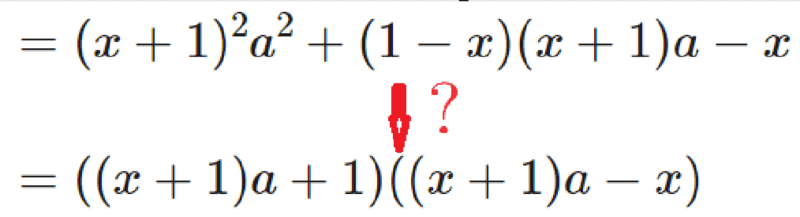

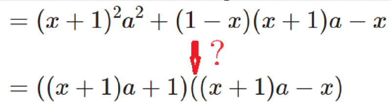

Can you tell me @SammyS how you factored the second last step to go to the last one?
Let me copy and paste those two steps for you as an image below.
Many thanks.
I'd do it so:
##=(x+1)^2 a^2+(1-x)(x+1)a-x##
##=(x+1)^2 a^2+(x+1)a-x(x+1)a-x##
##=((x+1)a+1)(x+1)a-((x+1)a+1)x##
##=((x+1)a+1)((x+1)a-x)##
Another way is to use identity of a common term: ##t^2+(a+b)t+ab=(t+a)(t+b)##
$$t \to (x+1)a$$ $$a \to 1 $$ $$ b \to -x$$ $$(x+1)^2 a^2+(1-x)(x+1)a-x= ((x+1)a+1)((x+1)a -x)$$

You asked how to go from
##\displaystyle \quad (x+1)^2 a^2+(1-x)(x+1)a-x##
to
##\displaystyle \quad ((x+1)a+1)((x+1)a-x)##
You have mentioned using grouping to factor in the OP. That's what @Hill uses in Post #16.
Adding some detail to doing the grouping:
First you need to split the "middle term", ##\displaystyle \quad (1-x)(x+1)a\ \quad## into two terms. The leading term (the ##a^2## term) has two factors of ##(x+1)\,,## so in the middle term, you need to split ##(1-x)## factor, keeping the ##(x+1) ## factor. This gives you the following.
##\displaystyle \quad (x+1)^2 a^2+(1)(x+1)a-x(x+1)a-x##
From this point, continue as @Hill did.
