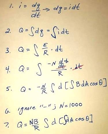

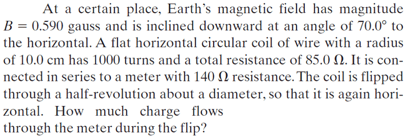

We were given this solution:[/B]

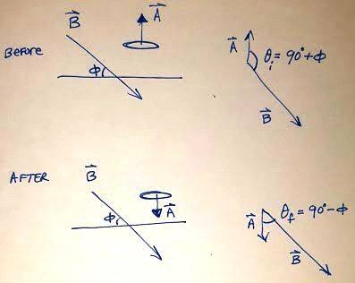

The above solution is leaving out a lot of intermediary steps. I don't agree that "the axis of the coil is at 20°, not 70°, from the magnetic field of the Earth." Technically, the coil's surface normal starts at an angle of θi=(90+70)=160°, and ends-up at θf=(90-70)=20° I want to produce a totally complete, step-by-step solution. Here's how I'm starting...

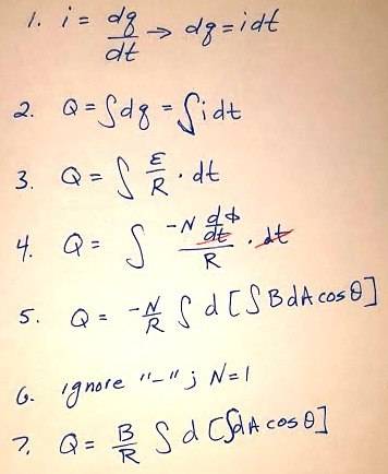

I'm not sure how to proceed after #7. How do I evaluate the integral (not sure how to deal with dA as the integration variable with cosθ sitting there??
Any help is appreciated!

The first thing I see is that eq. 5 is not correct. dΦ ≠ d(B⋅dA). You missed something in eq. 6 WRT dA. WRT eq 7 reconsider your integration limits.
The flux integral should be taken over the entire area of the loop at a given instant in time. In particular, ## \theta_i ## and ## \theta_f ## are not bounds for the inner (flux) integral--in fact, they're bounds for the outer (time) integral, since ## \theta ## is a function of time.
This actually simplifies things quite a bit, because as far as the inner integral is concerned, ## \theta ## is a constant--meaning that factor of ## \cos(\theta) ## can essentially be ignored when evaluating the integral. The expression $$ \int \cos(\theta) dA $$ then simply becomes ## A \cos(\theta) ##, where ## A ## is the total area of the loop.
I actually like the way you've written the expression in 7 quite a bit, although I haven't seen it this way before. Using this notation, we have: $$ \frac{-NB}{R} \int_{\theta_i}^{\theta_f} d (A \cos(\theta)) = \left( \frac{-NB}{R} \right) A (\cos(\theta_f) - \cos(\theta_i)) $$ Note that this is identical to the expression given in the solution, except for your minor disagreement about the values of ## \theta_i ## and ## \theta_f ##. I'll let you think about why that distinction actually doesn't matter in the end.
Thanks for your help!

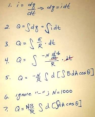

"The first thing I see is that eq. 5 is not correct. dΦ ≠ d(B⋅dA). "
Since Φ Ξ ∫B⋅dA, doesn't dΦ = d[∫B⋅dA] = d∫B(dA)cosθ?
"You missed something in eq. 6 WRT dA."
∫dAcosθ = A∫cosθ ? If so, is the integration variable dθ, and if so -- how does this come about?
"WRT eq 7 reconsider your integration limits."
Does the angle but the surface normal and the B-field not begin at 160° and end at 20°?
Thanks again for your help!
Very helpful (and educational!). Thank you so much!
One last question... in your last equation, how do you know to do d(cosθ)=Δcosθ rather than d(cosθ) = -sinθ ?
This is more or less notational. In the context of an integral, "d" doesn't really translate to "take a derivative"--think of it more as a label for the variable of integration. In particular, anytime you see an expression like this: $$ \int_a^b d[ \textrm{stuff} ] $$ the answer is always $$ \left. \textrm{stuff} \right]_a^b = \textrm{stuff}(b) - \textrm{stuff}(a). $$ For example, ## \int_a^b dx = b - a ##, despite the fact that "dx," interpreted as "the derivative of x," would just be a constant.
remember that in B⋅dA we are interested in the projected area in the direction of B, This projected area depends on the angel of B wrt dA and not dA itself. so
dΦ = ∫ dBdA +∫B⋅d(dA ) = ∫AΘ B⋅dAd(cosΘ) = A∫ΘsinΘdΘ which take care of eq 6 where you did not have an increment in the angle (dΘ) over which to integrate.
Yes you are correct.
