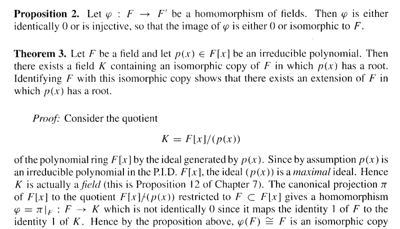

I am reading Dummit and Foote, Chapter 13 - Field Theory.
I am currently studying Theorem 3 [pages 512 - 513]
I need some help with an aspect the proof of Theorem 3 ... ...
Theorem 3 on pages 512-513 reads as follows:
In the above text from Dummit and Foote, we read the following:

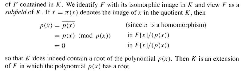

" ... ... We identify ##F## with its isomorphic image in ##K## and view ##F## as a subfield of ##K##. If ##\overline{x} = \pi (x)## denotes the image of ##x## in the quotient ##K##, then
##p( \overline{x} ) = \overline{ p(x) }## ... ... (since ##\pi## is a homomorphism)
... ... "My question is as follows: ... where in the proof of ##p( \overline{x} ) = \overline{ p(x) }## does it depend on ##\pi## being a homomorphism ... ...
... indeed, how does one formally and rigorously demonstrate that ##p( \overline{x} ) = \overline{ p(x) }## ... ... and how does this proof depend on ##\pi## being a homomorphism ...
To make my question clearer consider the case of ##p(x) = x^2 - 5## ... ...
Then ...
##p( \overline{x} ) = \overline{x}^2 - 5_K##
##= ( x + ( p(x) ) ( x + ( p(x) ) - ( 5 + ( p(x) )##
##= ( x^2 + ( p(x) ) - ( 5 + ( p(x) )##
##= (x^2 - 5) + ( p(x) ) = 0##
##= \overline{ p(x) }##... ... in the above case, my question is ... where does the above calculation depend on ##\pi## being a homomorphism ... ?
Hope someone can help ...
Peter

The proof does not demonstrate that ##p(\overline x)=\overline{p(x)}## *. It is left 'as an exercise for the reader'.
Here are the missing steps. We write ##p(x)=\sum_{k=0}^n a_kx^k##:
\begin{align*}
p(\overline x)&=
\sum_{k=0}^n a_k\overline x^k\\
&=\sum_{k=0}^n a_k\pi(x)^k\\
&=\pi\left(\sum_{k=0}^n a_kx^k\right)\\
&\quad\quad\quad\textrm{[HERE we have used the homomorphism property to move the additions and multiplications inside the }\pi\textrm{ operator}]\\
&=\left(\sum_{k=0}^n a_kx^k\right) + (p(x))\\
&=p(x)+(px(x))\\
&=(p(x))\\
&=0_K
\end{align*}
* Indeed, depending on how one interprets the author's statement that ##\overline x=\pi(x)##, the symbol string ##\overline{p(x)}## may not even be defined.

Math Amateur said:
Surely we can just prove that ##p( \overline{x} ) = \overline{ p(x) }## in the field ##F[x] / ( p(x) )## by simply considering the nature of the cosets of the quotient ... and in particular the rules for adding and multiplying cosets ...
The difficulty is that ##\overline x## is defined as ##\pi(x)##, so we cannot even state the claim ##p( \overline{x} ) = \overline{ p(x) }##, let alone prove it, unless we have defined ##\pi##.
Also, recall that the key claim of Theorem 3 is that ##K## contains an isomorphic copy of ##F##. The easiest way to demonstrate that is to create an injective homomorphism into ##K## from a field that is isomorphic to ##F##. That injective homomorphism is ##\pi|_{F'}## where ##F'## is the subring of ##F[x]## consisting of polynomials of degree 0, which is isomorphic to ##F##.
So we have ##F\cong F'\cong Im\ \pi|_{F'}##. In the book they identify ##F'## with ##F## but I find it clearer in this context to highlight the difference.
