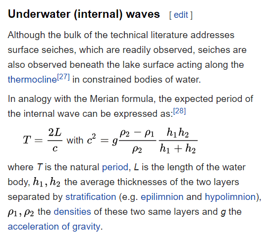

Sorry,my English sucks.yes,I mean ,1 minute of arc.I have a device which has been doing plane motion and its height always slight changing (nonuniform polishing process).
For some reason, I need to find a horizontal plane on this device as the base level. So I thought of this way.I will appreciate it if you can give me any advice.If there is something you are not clear about, I will be happy to explain for you.
The supplement of my question:A piece of wood floats on the surface of the water.Similarly,what happen when an object floats on the stratified surface of two liquids?
It is still unclear what you are asking, so I made a picture. You have two liquid media of different densities, so one floats on the other. You also have an non-uniform device floating on the surface between two media. You want to find a horizontal plane on this device. How do you define that? Is it the black line on this picture?

What you say is basically correct, do you know the mathematical equation that a relatively heavy object floating in the oil-water interface with some slight disturbance?
Neglecting oscillation of the device, just the waves in the liquids, the equation was given in the Seiche article I linked in post #2.
That formula gives you the period. The amplitudes are variable, so there is no specific formula for that.
Edit: Also see https://en.wikipedia.org/wiki/Ship_motions about the six axis of rocking of the device itself, superimposed on top of the waves in the liquid. If you need a detailed simulation, it won't be simple.I still don't understand your objective. Are you polishing the device to make it uniform thickness? If so, there may be very different ways to accomplish that.
