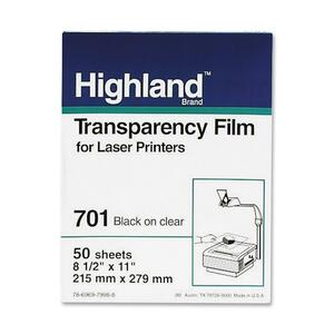

thanks so far guys.
I'll try using the wax paper. Would the clear film paper used for projections work as well?

BTW. Have you given 'cling -wrap" type plastic a try. It's very thin and might give you a higher capacitance.
I tried using a variety of plastics, paper, and also film (projection film). I'm going to try wax paper and cling film as well, following your suggestion. Thank you
