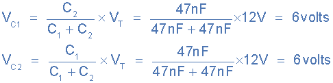

because you are going to get a voltage drop across each capacitor. and totalling up the voltage drops will equal the supply voltage the same as for resistors in series
as an example ...
Dave

Hey daaven,
Thanks for welcoming me to PF and thanks for the response! Like you showed in your post, the math very much so works out. But I'm still unclear about what phenomena is going on under the hood that address my original question(s).
I'm trying to figure out the phenomena that explains why the battery will only add a quantity of charge onto the +plate of C2 that is the same magnitude as the quantity of charge found on the middle plates that are in the purple region of my circuit diagram.
That brings me to my confusion about comparing of the +plates on C1 and C2 when they are fully charged. When I look at it from one way,their electric potential must be the same because they are connected to those same batteries by wires and are in a state of electrostatic equilibrium. This means that no point within the conductor has an electric field (which means no electric potential); This makes sense. But when I look at it from another angle then I am confused because they are essentially the same plate with different amounts of charge on them, yet they wield the same electric potential. This doesn't seem right with me.
I'm having a problem seeing what the 'other angle' is. B is electrically A with a center plate added.
