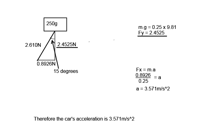

A fuzzy die hanging from a string of a car's rear view mirror is deflected 15 degrees from the vertical. what is the car's acceleration if the die's mass is 250g
basic forces equations
trig
  • Free-body force diagram of a hanging 250g die deflected 15 degrees from vertical, with tension 2.610N, vertical component 2.4525N and horizontal component 0.8926N; side notes show mg = 0.25 x 9.81, Fx = m.a giving a = 3.571m/s^2.

You have an error in Fx ?
if that is a triangle with a 15o angle, then the opposite side is not what you said - much smaller. The hypotenuse isn't that big either ?
Other than that, your reasoning is good.
EDIT: looks like you used 20o

ahh right, the calculations are wrong, but is the method right?
