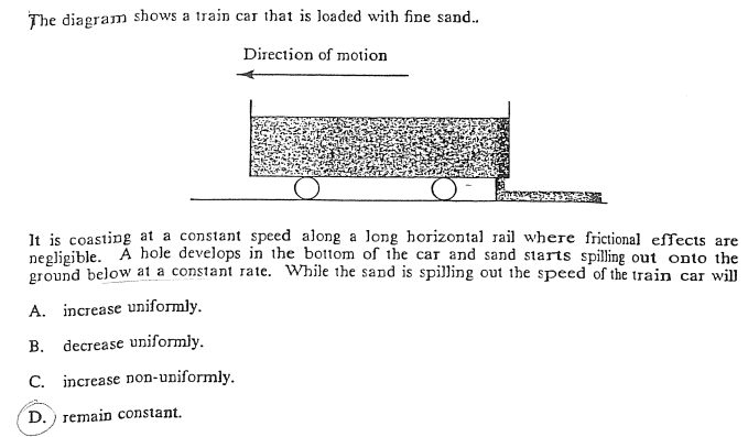

Please see below
Momentum
Impulse
Conservation of momentum
I have several confusion about this question:
1) Since the sand spilling out downwards, it means that there is change in momentum in vertical direction (before the sand spills and after the sand spills) but no change in momentum in horizontal direction so no net force in horizontal direction and no acceleration in horizonal direction, so the speed of the train car will be constant. Is this correct?
2) If I consider the momentum of the system (train car + sand inside train car) in horizontal direction, the momentum will decrease because the speed is constant and the mass of sand decreases. But this means that the there is change in momentum in horizontal direction so the momentum in horizontal direction is not conserved and there will be net force acting on the system so the speed can't be constant, which contradicts to what I thought in part (1)
3) I want to know how the momentum of spilling sand affects the system so I draw free body diagram for the train car. There will be 3 forces acting on it, normal force from ground acting upwards, weight of the train car and also weight of sand (both acting downwards). Initially, normal force = weight of train car + weight of sand (to prevent vertical motion).
When the sand spills out, there will be additional force due to the change in momentum of spilling sand in vertical direction, directed downwards. The weight of sand in the train car decreases so to prevent vertical motion of train car:
Normal force from ground on train car = weight of train car + new weight of sand + downwards force due to change in momentum of spilling sand
Is that correct?
And if I want to compare normal force before and after the sand spills, can I say they will be the same? Maybe because the decrease in weight of sand in the train car will be the same as the downwards force due to change in momentum (I don't really know the reason behind this, just guessing)
Thanks

Your first answer is correct - the train continues at constant velocity. Recall the equation of motion for variable mass systems ##\mathbf{F} + \mathbf{v}_{\mathrm{rel}} \dfrac{dm}{dt} = m \dfrac{d\mathbf{v}}{dt}##. Since the sand is ejected at ##\mathbf{v}_{\mathrm{rel}} = \mathbf{0}##, and frictional effects are negligible (##\implies \mathbf{F} = \mathbf{0}##), then ##\mathbf{v}## is constant.
[If you would like to derive this equation then you should consider either conserving the momentum of a system of fixed mass (e.g. train ##+## sand which is ejected in time ##\delta t##), or otherwise using the Reynolds transport theorem of vector calculus.]
For the normal force ##\mathbf{N}##, you just need to look at the vertical component of the variable mass equation.

The way I would recommend thinking of this is through conservation of momentum in the form:
Change of momentum = external forces - momentum carried out of the system.
Since sand is flowing out of the system, momentum is being carried out at a rate of ##-\dot m v##, where ##v## is the speed of the sand. If the external forces are zero, then ##\dot p = \dot m v## (note that ##\dot m## is negative).
If the speed of the dropped sand is equal to the speed of the cart, then ##p = mv## resulting in ##\dot p = ma + \dot m v = \dot m v## and therefore ##a = 0##.

Ah I see. The closed system should be train car + sand inside train car + spilling sand. Is this correct?
Yes. So if the car had absurdly large wheels so that the first sand didn't hit the floor until the last sand leaked out of the car then (neglecting air resistance) the falling column of sand would be always underneath the hole. Momentum is then conserved.
Alternatively you can give the Earth a very large but finite mass and include it, and the friction forces that stop the sand, in your calculations.

No. The system is car + sand in the car. Momentum is flowing out of this system by the system boundary being redrawn by sand carrying momentum with it exiting the system.

Do I need to pay attention to the direction in which momentum is being carried out at a rate of −m˙v (I think it is downwards in this case)?
It is not downward. Only the horizontal components matter for the speed of the cart. The rate is ##-\dot m v## because ##\dot m## (the mass change of the cart+sand) is negative and the negative of this quantity is the mass carried out of the cart+sand system.

I think I see what you mean. You choose to define a system with variable mass. OK, say I look at the system at some time t0 after an amount of sand has fallen out and then again at t = t0+dt. In time dt, mass dm which is part of the system has fallen out of the car and is moving with horizontal speed v. Are you saying that this dm is no longer part of the system because it fell out of a hole and the boundary of the system has been "redrawn" without it? Why is that necessary?
Variable mass systems are fraught with pitfalls. If one must include the sand as a system component, I think it is simpler to include all the sand. Then in the horizontal direction, there is friction force ##f=-\dot m_{\text{sand}}v## acting on the component of the system that hits the ground. One could write in the horizontal direction ##P_{\text{sys}} =m_{\text{car}}v + m_{\text{sand}}v##, in which case $$\dot P_{\text{sys}}=F_{\text{net}}=0+(-\dot m_{\text{sand}}v).$$The time derivative of the car's momentum is zero because there is no unbalanced force acting on the "car" component of the system.
The bottom line is that there is no horizontal momentum exchange between car and sand, only between sand and ground. Therefore defining just the car as the system is sufficient to answer the original question.
