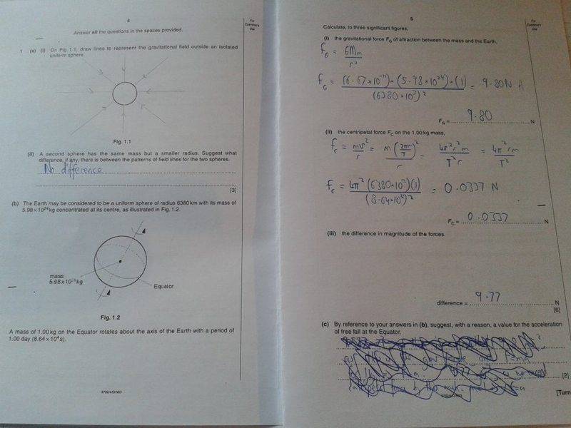

There's a sphere with the mass of the Earth and same radius.It rotates at constant speed. It hhas the period of the earth. a mass of a kg sits on the surface.
1) find grav force on mass
2) find centripetal force on mass
3) find the difference in magnitude between them
4) suggest a value of acceleration of free fall for the mass.
Cant do last part; the way I see it is that the centripetal force does not exist separately; it is criteria for circular motion at constant speed. So clearly the gravitational force over-provides, but I don't understand how this excess is related to the acceleration.

The acceleration due to gravity and centripetal force are in the same direction if you are on the equator. I would use the equator as your teacher probably expected. Then it's easy to add the two acceleration vectors together. And g is easy if we use the standard r at the equator. And then Ac is easy if we use the equator. Note you will have to find v by looking up r. I'm thinking this is what your teacher wants you to do.
And the gravitational force idea just states that any two masses attract each other with the same force. But one can also see that an object on the surface is also changing direction( if not exactly on a rotational pole) so there must be centripetal force as well. And Fc Is supplied by the force of gravity.
The actual question:
Jamessamuel said:
Pretty far , I am english so certainly on a smaller radius than the mass in the question, which is on the equator.
This is the first time you have stated it is on the equator. This is why Simon asked for the latitude.
This is backwards.
Centripetal force is not some extra force that you can add on to gravity. It is a required component of the resultant force, namely, that necessary to keep the object traveling on the arc. See https://www.physicsforums.com/insights/frequently-made-errors-pseudo-resultant-forces/
The two forces acting on the mass are gravity and the normal force from the surface. The resultant of the two is the centripetal force. The apparent weight of the mass is equal and opposite to the normal force.
