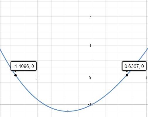

Next, let's look at a plot of our function $f$ and see how many roots there are and get a rough estimate of their values:
Now, ignoring for the moment the root approximations shown on the graph, let's just say we see that the smaller root is about -1.5 and then use Newton's recursive method to get an accurate approximate of this smaller root

Our last two successive approximations agree to 15 digits, so let's now find the other root, which we see is near x=0.5:
$$x_0=0.5$$
$$x_1\approx0.644107890053782$$
$$x_2\approx0.636750907010919$$
$$x_3\approx0.636732650918014$$
$$x_4\approx0.636732650805282$$
$$x_5\approx0.636732650805282$$
Our last two successive approximations agree to 15 digits, so we now have the two root approximations:
$$x\approx-1.40962400400260,\,0.636732650805282$$
Let's now verify that they are close approximations:
$$\sin(-1.40962400400260)\approx-0.987039832660$$
$$1-(-1.40962400400260)^2\approx-0.987039832660$$
$$\sin(0.636732650805282)\approx0.594571531399$$
$$1-(0.636732650805282)^2\approx0.594571531399$$
And so, using 12 decimal places of accuracy, we have found the points of intersection may be approximated by:
$$\bbox[10px,border:2px solid #207498]{(x,y)\approx(-1.409624004003,-0.987039832660),\,(0.636732650805,0.594571531399)}$$
