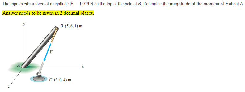

LeftBrain
A (0,0,0)
B(5,6,1)
C(3,0,4)
|F|= 1919N
Cartesian:
B= {5i + 6j + 1k}
C= {3i + 4k}
rCB ={2i + 6j - 3k}
|rCB| = sqrt(22 + 62 + 32) = 7
Unit vector = rCB / |rCB| = {2/7i + 6/7j - 3/7k}
F = |F| * Unit vector = 1919 {2/7i + 6/7j - 3/7k} = 548.29i + 1644.86j - 822.43k
Now firstly, I'm not sure if I even did the above part correctly, but to find the moment I'm a bit lost and my don't seem to have much in my notes about this...
I think the next step is using cross product, but I'm a bit lost as to which arm to take to find moment about A...
If I use rBA I get:
MA = rBA x F = 6579.44i - 4660.44j - 4934.56k
WELP! Need help!
Cheers LB

This is not the r-vector for use in calculating the moment about point A. What is the r-vector you need instead?
(Hint: What is the Force pulling on?)

See above. Remember, the problem asks for the magnitude of the moment, so don't forget that!
So I need to use rBC instead?
No, you need to use the r-vector which connects point A to the end of the rope pulling on the end of bar AB.
Remember, calculating a Moment requires a Force and some kind of Distance between the force and the axis of rotation caused by the moment.
