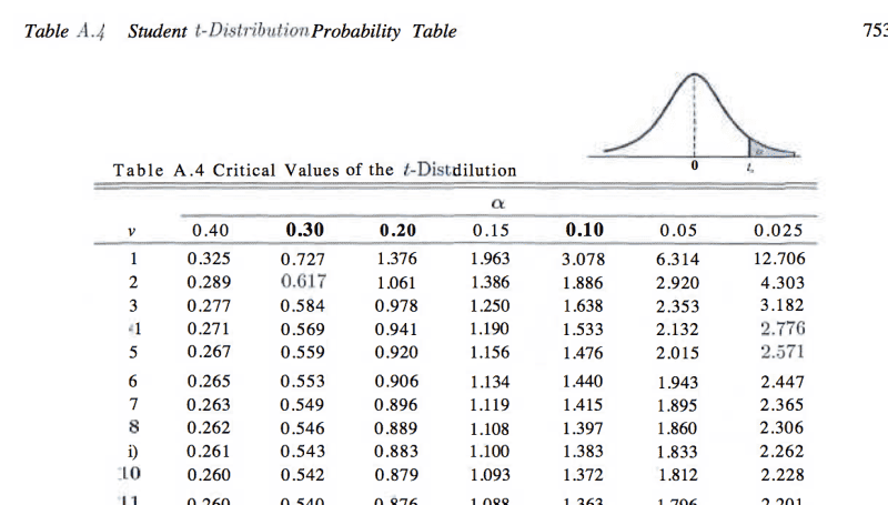

This is from a practice exam:
Cartons of grommets are purchased from a manufacturer. Given the sample weights
41.7 40.6 42.4 42.7 41.5
41.0 42.5 40.4 41.2 42.6
a) Find the probability that the average weights of 5 cartons of grommet is between 40.5 and 42.4
b) Find the probability that the average weights of One carton of grommet is between 40.5 and 42.4
t-distribution?
I feel like if I start with part (b) and fine the probability that 1 carton falls in the interval, I can then apply the binomial distribution to find the prob that 5 cartons fall in that interval. But I am very lost as to where to start. How can I calculate a t-value without a mu value?
Any thoughts on this one?

Funny. This same exact problem was on the actual exam tonight and I still could not get it. I thought that a "T-text" made use of the fact that the random variable [tex]T = (\bar{X} - \mu)/(S/\sqrt{n})[/tex] has a t-distribution with [itex]\nu[/itex] = n - 1, right?
Let me ask this so that I know that I am interpreting the question properly: for part (b) I am being asked to find [tex]P(40.5 < \bar{X} < 42.4)[/tex] correct?
Yeah. So you let [itex]\mu[/itex] equal your sample mean, S equal your sample standard deviation. Now you can figure out what the t-score of those intervals is, and use the t-distribution to find the probability. For the bundle of 5, you just multiply the size of the t-score interval by [itex]\sqrt{5}[/itex].
I assume b means "suppose we take another carton. What is the probability that that carton's weight is in that interval?" If the question is supposed to mean "What is the probability that the population mean lies on this interval"...well, that's not an appropriate question to ask.
OK. So let's say that I calculate my t-values and I get t1 and t2. I then need to find the probability P(t1 < T < t2). Does this seem like something you would use the "t-tables" for? Or the actual PDF of the t-distribution? I ask because the t-values are tabulated but degrees of freedom AND confidence (alpha). For example, the t-tables look like that below.
Just use the row for 9 degrees of freedom (since you had 10 data points).
