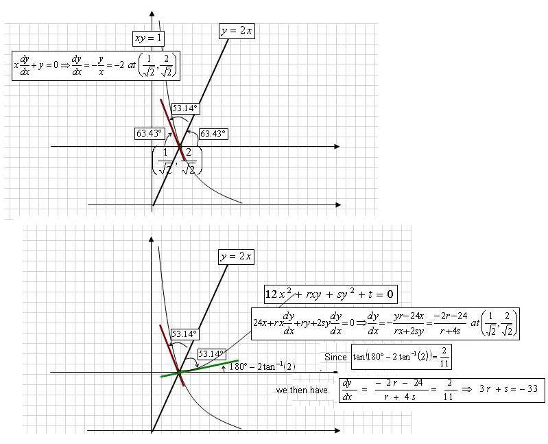

Hi MHB,
I recently found an interesting problem which I initially thought I could solve without much trouble, but after I started to work on it, I found out that this has not been the case and this problem has driven me crazy, as I find no good way to attack it...so, I desperately need some help on this problem.
Problem:
The graph $xy=1$ is reflected in $y=2x$ to give the graph of $12x^2+rxy+sy^2+t=0$. Find $rs$.
I tried to sketch its graph and here is my sketch:
I managed only to get down to finding the relation between $r$ and $s$, i.e. $(3r+s=-33)$, but not the value of the product of them.
Thanks in advance for any help that anyone can offer.

Re: Find rs
I haven't checked your work thoroughly, but one error I see is:
$$\tan\left(\pi-2\tan^{-1}(2) \right)\ne\frac{2}{11}$$
This should be:
$$\tan\left(\pi-2\tan^{-1}(2) \right)=\frac{4}{3}$$
But, this still does not resolve the issue.

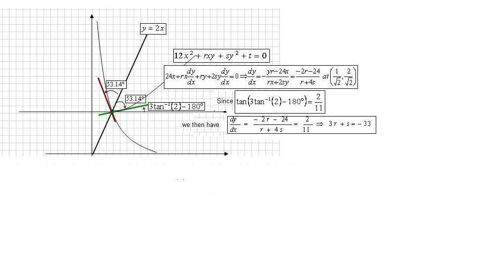

Ops...my bad...I labeled the diagram, the angle between the gradient line of the reflected graph at the intersection point wrongly...:o
I've uploaded a corrected version of the graph, as shown below:
and now, after substituting the values of $r=-7$ and $s=-12$ into the equation
$$\frac{dy}{dx}=\frac{-2r-24}{r+4s}$$
we get
$$\frac{dy}{dx}=\frac{-10}{-55}=\frac{2}{11}$$
but when I tried it with the equation that I simplified, which is $3r+s=-33$, I got $3(-7)+(-12)=-43$...
And I don't know what went wrong with the simplified equation that I obtained...(Angry)

But $$3(-7)+(-12)=-21-12=-33$$...(Clapping)

Argh!:mad: I couldn't believe I made such a silly mistake here...and thanks for catching this up for me!

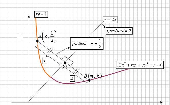

Hey our naughty and playful global moderator, aka MarkFL,
You're right, I found another way to solve for the values for $r$ and $s$ using my method.
My solution:
The line $y=2x$ is the perpendicular bisector of the segment AB and this fact leads us to many useful results:
1)
The gradient between the point $A(a, \frac{1}{a})$ and $(1, 2)$ tells us the value for $a$...
$$\frac{2-\frac{1}{a}}{1-a}=-\frac{1}{2}$$ implies $$a=\frac{5-\sqrt{17}}{2}$$.
and
The gradient between the point $B(m, k)$ and $(1, 2)$ tells us the relation between $m$ and $k$...
$$\frac{k-2}{m-1}=-\frac{1}{2}$$ implies $$m=5-2k$$.2)
We see that the curve of $12x^2+rxy+sy^2+t=0$ passes through the intersection point$$\left(\frac{1}{\sqrt{2}},\;\;\frac{2}{\sqrt{2}} \right)$$ between the curve $xy=1$ and the line $y=2x$ and if we merge all these data together with the relation between $r$ and $s$ where $3r+s=-33$, we get
$t=5r+60$
3)
The exact same distance between the point $$A(a, \frac{1}{a})=\left(\frac{5-\sqrt{17}}{2},\; \frac{2}{5-\sqrt{17}} \right)$$, $(1, 2)$ and $B(m, k)=(5-2k, k)$, $(1, 2)$ tells us the value for k...
$$\left(2-\frac{2}{5-\sqrt{17}} \right)^2+\left(1-\frac{5-\sqrt{17}}{2} \right)^2=(k-2)^2+(5-2k-1)^2$$
Solving the equation above we get $$k=\frac{11-\sqrt{17}}{4}$$
At this point, we have all that we need to solve for the value of $r$.
$$12\left(\frac{\sqrt{17}-1}{2} \right)^2+r\left(\frac{\sqrt{17}-1}{2} \right)\left(\frac{11-\sqrt{17}}{4} \right)-(33+3r)\left(\frac{11-\sqrt{17}-1}{4} \right)^2+5r+60=0$$
$r=-7$
$s=-33-3(-7)=-12$
and hence
$rs=(-7)(-12)=84$ and we're done!

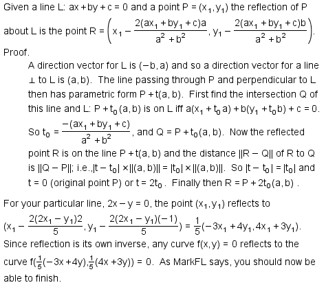

johng said:
Hi,
Here's my version of reflection about a line:
Thank you for the note, johng!:)
