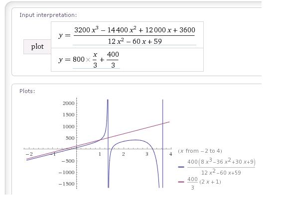

According to your suggestion, I get:
$$100y^3-3(150)y^2+3(125)y+3(\frac{75}{2})=a\left( \frac{3y^2}{8}-\frac{15y}{8}+\frac{59}{32} \right)$$
And I even sketched the functions of $f(y)=100y^3-3(150)y^2+3(125)y+3(\frac{75}{2})$ and $g(y)=\dfrac{3y^2}{8}-\dfrac{15y}{8}+\dfrac{59}{32}$ but I don't see the relation between $a$ and the given restriction where $0 \le y \le 2.5$ and the newly formed equation, and hence how to find the number of real order pairs of $(a, y)$ based on that.
Hmm...if I express $a$ as the subject of the formula, I get:
$$a=\frac{100y^3-3(150)y^2+3(125)y+3(\frac{75}{2})}{\large \left( \frac{3y^2}{8}-\frac{15y}{8}+\frac{59}{32} \right)}$$
$$\;\;\;=\frac{3200y^3-14400y^2+12000y+3600}{12y^2-60y+59}$$
$$\;\;\;=\frac{800y}{3}+\frac{400}{3}+\frac{12800}{3} \left(\frac{y-1}{12y^2-60y+59} \right)$$
$$\;\;\;=\frac{800y}{3}+\frac{400}{3}+\frac{12800}{3} \left(\frac{y-1}{12(y-3.6547)(y-1.3453)} \right)$$
And if I plot the sketch of $a$ versus $y$, I get:
From the graph, we can tell there are infinitely many real order pairs of $(y, a)$, with $a\ne 1.3453$ for $0 \le y \le 2.5$.
I think I have solved this problem! :)
