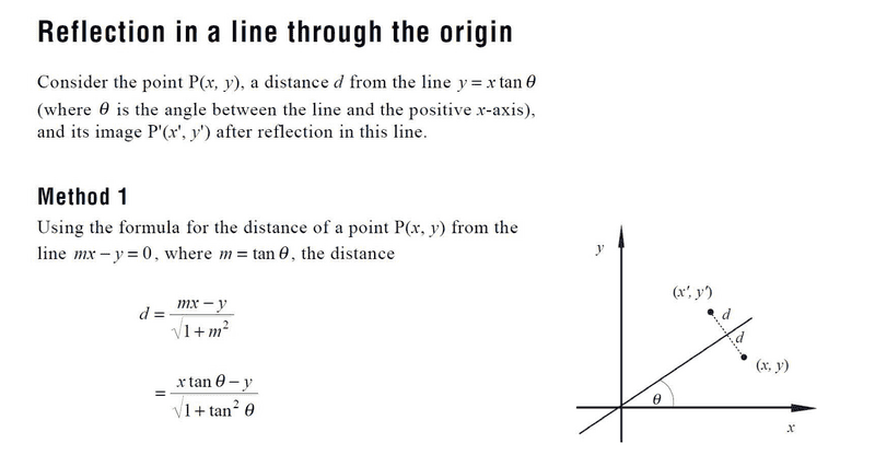

see attached.
distance formula
Printed notes titled Reflection in a line through the origin, showing point P(x, y) reflected to P'(x', y') across the line y = x tan θ, Method 1 deriving d = (mx − y)/√(1 + m²), and a diagram of the line through the origin with angle θ and the two points.
My problem is on how to arrive at ##d=\dfrac{mx-y}{\sqrt{1+m^2}}##
My working steps are as follows;
##d^2=(x_1 - x)^2+ (y_1-y)^2##
##d^2=(\dfrac{y}{m} -x)^2+ (mx-y)^2##
##d^2=\dfrac{(mx-y)^2}{m^2} + (mx-y)^2##
##m^2d^2=(mx-y)^2(1+m^2)##
##d=\dfrac{mx-y\sqrt{1+m^2}}{m}##
...unless they made a mistake!

If there is a formula then that is fine. I will need to look at it.
I used the distance formula,
##d=\sqrt{(x_1-x_2)^2 + (y_1-y_2)^2}## with my points being, ##(\frac{y}{m}, mx)## and ##(x,y)## the rest of the working (check my second line) ought to be clear to you sir.
I can see my mistake, i failed to take into consideration the intersection points between the line and the external point.
We have to determine the points of intersection between the external point and our line ##y=mx## we shall use the normal equation of the line ##\left[\dfrac{y-y_0}{x-x_0}\right] =\left[ \dfrac{-1}{m}\right]##... that is perpendicular to the straight line ##y=mx## this will eventually lead us to the final equation, ##d=\dfrac{|k+mx_0-y_o|}{\sqrt{1+m^2}}## , our line equation being ##y=mx+0##, the result would be ##d=\dfrac{mx-y}{\sqrt{1+m^2}}## which is as shown on the text.

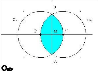

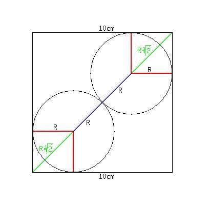

Consider d to be the radius of a circle to which the line is a tangent.
The tangent to the circle is perpendicular to the radius of the circle at the point of contact.
In this case, we have two circles of equal radii d, intersecting at a single point with a line that is tangent to both.
The distance between the centers of those circles is 2d.
