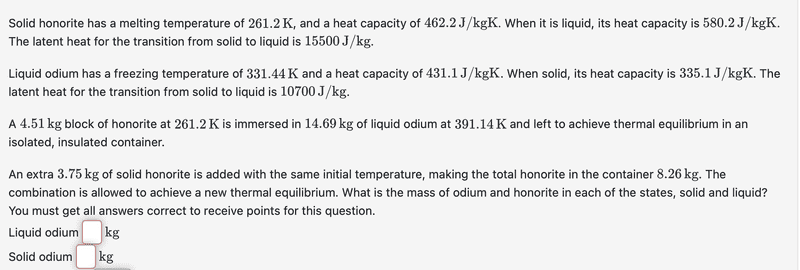

Solid honorite has a melting temperature of 261.2K, and a heat capacity of 462.2J/kgK. When it is liquid, its heat capacity is 580.2J/kgK. The latent heat for the transition from solid to liquid is
15500J/kg.Liquid odium has a freezing temperature of 331.44K and a heat capacity of 431.1J/kgK. When solid, its heat capacity is 335.1J/kgK. The latent heat for the transition from solid to liquid is 10700J/kg.
A 4.51kg block of honorite at 261.2K is immersed in 14.69kg of liquid odium at 391.14K and left to achieve thermal equilibrium in an isolated, insulated container.
An extra 3.75kg of solid honorite is added with the same initial temperature, making the total honorite in the container 8.26kg. The combination is allowed to achieve a new thermal equilibrium. What is the mass of odium and honorite in each of the states, solid and liquid?

Mass of honorite initially: 4.51 kg at 261.2 K
Additional mass of honorite added: 3.75 kg at 261.2 K
total mass of honorite is 4.51 kg + 3.75 kg = 8.26 kg
Mass of liquid odium: 14.69 kg at 391.14 K
Q melt = m honorite × L honorite
Qmelt = 8.26kg × 15500J/kg
Qmelt = 128030 J
Q cool = (m odium) × (c liquid odium) ×(T initial−T freeze )
Qcool = 14.69kg × 431.1J/kgK ×(391.14K−331.44K)
Qcool = 378071.6823 J
Qexcess = Qcool − Qmelt
Qexcess = 378071.6823 J−128030J= 250041.6823 J
(m odium, freeze) = Q excess / L odium
(m odium, freeze) = 250041.6823/10700
(m odium, freeze) = 23.368 kg
Mass of solid odium = 23.368 kg
But both are incorrect. Could someone please let me know where is the error?

I found the correct answer for solid odium ie 8.157 kg but I am still struggling with the liquid mass. I also tried 14.69 - 8.157 = 6.533 for liquid but this is still not correct. Could someone please spot the error for me. Thanks
If you have correctly quoted the initial liquid mass and you result for final solid mass is correct then so is your result for final liquid mass.
But since the 14.69 only has two decimal places your answer should not have three. 6.53 would be better.
