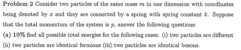

I upload the original problem file.
I will try to solve the problem (1).

BookWei said:
Thanks a lot.
Okay, so the question setter does believe you can attach fermions and bosons to a spring. On the face of it, the natural length of the spring should be relevant, but I think you'll just have to do the maths and see what happens.
