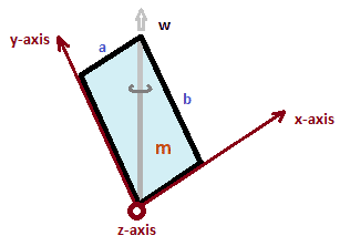

A uniform flat rectangular sheet of mass m and side lengths a and b rotates with angular speed w around a diagonal. What torque is required? Given a fixed area A, what should the rectangle look like if you want the required torque to be as large as possible? What is the upper bound on the torque?
##x\ \rightarrow\ a\ ,\ y\ \rightarrow\ b\ , z\ =\ 0 ##
##A\ =\ ab ##

We defined ##\phi## as the angle from the x-axis, such that:
$$\vec{w} =\ wcos(\phi)\hat{x} + wsin(\phi)\hat{y} + 0\hat{z} $$
Which is just equivalent to ##w\hat{r}## in spherical coordinates, where ##\theta =\ \pi/2##

$$a = \pm \sqrt[4]{-1} \sqrt{A}$$I seem to get a complex solution, which I don't expect to be correct, but I can't quite point out were it all went wrong. Is my angular speed correct? I've been stuck on this for quite a while and any help would be much appreciated!
Your work looks good to me up to where you are trying to maximize the torque. Should the angle ##\phi## be treated as a constant when taking the derivative with respect to ##a##?
[Edit: I think you can simplify your expression for the torque in terms of ##a## and ##b## if you express the trig functions in terms of ##a## and ##b##.]
Dam. You are completely right.
So i basically would make ##\phi = \phi(a)##, and take the respective derivatives.
What I'm wondering about this is that since for example, ##sin(\phi(a)) = \frac{b}{\sqrt{a^2+b^2}}##, could i just say that ##\frac{d}{da}sin(\phi(a)) = cos(\phi(a)) \frac{d\phi(a)}{da}##, or would I have to first plug in the prior, then in ##b = A/a## and then take the derivative?

Yes. Using ##\sin\phi = \frac{b}{\sqrt{a^2+b^2}}## (and similar expression for ##\cos \phi##), I find that your expression for the torque can be compactly expressed in terms of just ##a## and ##b##. Then you can let ##b = A/a## and take the derivative with respect to ##a##.

edit: I've solved and resolved this solution by hand a few times now and I keep coming up with ##\frac{d\tau}{da} = \frac{2}{3}mw^2\frac{a^3A^2}{(a^4 + A^2)^2}##. I even redid the problem by setting my origin as the centroid of the sheet, so that ##\textbf{I} = \begin{smallmatrix} I_{xx} & 0 & 0 \\ 0 & I_{yy} & 0 \\ 0 & 0 & I_{zz} \end{smallmatrix}## and since ##\vec{w} = \begin{smallmatrix} w_x \\ w_y \\ 0 \end{smallmatrix}##, then ##\vec{L} = I_{xx}w_x\hat{x} + I_{yy}w_y\hat{y}##. From there it's pretty straight forward, but I end up with the same answer as the one above (which kind of proves the symmetry argument being able to use only the principle moments). Is something off in my setup you think?
I don't see anything wrong. Your calculations look correct to me. Assuming your answer is correct, how would you answer the question? A graph of the torque as a function of ##a## might help.
I guess I really wanted a more finite answer, but that's not always true in physics.
My derivative ##\rightarrow 0## when ##a \rightarrow \inf##, which mean this sheet starts to look like an infinitely long and thin line along the axis of the diagonal and the angular velocity vector.
Solving ##\tau## when ##a >> A##, then ##\tau = \frac{m}{12}w^2A## . That's a nice clean answer!
