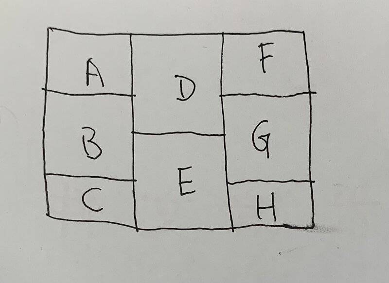

We have a figure which has been divided into 8 regions (A to H) as shown below. Each region must be colored in exactly one color. There are four colors to choose from: yellow, red, green and blue. There is only one other constraint: neighboring regions must not be of the same color.
Find the total number of ways of coloring the regions A to H.

It may help to first work through a smaller, simpler problem.
If you know some graph theory, have you come across chromatic polynomials?

Really? That looks a bit tough to me. Using the deletion-contraction theorem I got 768 quite quickly.

I got the same answer accumulating the product of 8 numbers in my head, 6 of which are 2:
How many ways can you colour D? (d)
Given a colouring for D, how many ways can you colour E? (e, so what is de?)
Given a colouring for D and E, how many ways can you colour B? (b, so what is deb?)

Very neat. Interestingly, it mirrors the deletion-contraction approach, in reverse order.
To be looking up vertex colouring, the OP first had to recognise the duality between vertices and regions.
