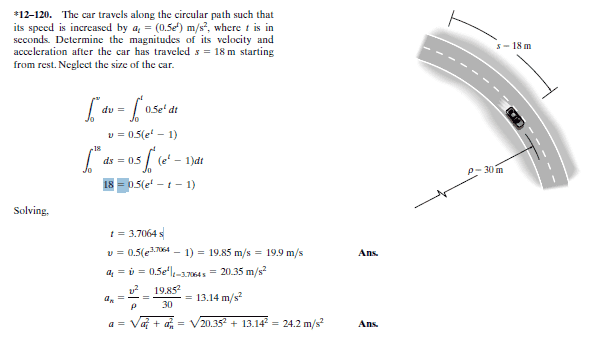

s = 0.5(e^t - t - 1)
t=?
when s=18
the use of natural log probably
I tried using the natural log rule but I am getting stuck. Please help me out here. If someone could give a step by step solution,I'll be rreally glad, Cheers

It's a hard forum requirement that you show some work, what you tried, what you thought, etc. Nobody here will write out the entire solution for you.
@Math_QED
18=0.5e^t - t -1
19 = 0.5e^t -t
ln(19) = tln(0.5)-lnt ??
Are you looking for only positive solutions for ##t##? How many solutions do you think there are in total? Make a graph.
It is probably not possible to find an expression for ##t## in terms of standard functions, so you may have to call upon a numerical root finder.
Here, t represents time so if there's a easier way to find only the positive values, then i'd like to know that please :(
There is no solution (positive or otherwise) in terms of elementary functions, so if this is a homework problem that asks you to find an exact solution, you may have to re-read the problem.
If this is indeed the correct equality, then you could proceed to make a graph to get an idea of where the solution may be. Then you can invoke a root finding to determine it approximately.
@Krylov this is the solution. but I am not sure how he got to the value of t :/

View attachment 107467@Krylov this is the solution. but I am not sure how he got to the value of t :/
No, ##t = 3.7064## does not satisfy ##18 = 0.5(e^t - t - 1)##. (Try it.) It satisfies this equality only approximately and it was probably found using a numerical root finder or by reading it off from a sufficiently detailed graph.
What the heck?! I've wasted pages just to get the answer but i couldnt. I'll sue the author for this! lol . I'll take this question to my dynamics teacher and see what he comes up with. Thanks man! @Krylov
You can't solve [tex] e^t - t = 37[/tex] analytically; if you have a calculator, then the iteration [tex] t_{n+1} = \ln(t_n + 37)[/tex] with [itex]t_1 = 0[/itex] converges rapidly to [itex]t = 3.706384959[/itex] to the precision my calculator will display. (How did I know to try that instead of [itex] t_{n+1} = e^{t_n} - 37[/itex]? For the iteration [itex]t_{n+1} = f(t_n)[/itex] to converge to a solution of [itex]t = f(t)[/itex] which you know to exist then you must have [itex]|f'(t)| < 1[/itex] near that solution. [itex]\ln(t + 37)[/itex] has derivative [itex]0 < 1/(t + 37) < 1[/itex] for all [itex]t > 0[/itex]; [itex]e^t - 37[/itex] has derivative [itex]e^t > 1[/itex] for all [itex]t > 0[/itex].)

No, absolutely NOT.
$$\ln(0.5 e^t - t) \neq t \ln(0.5) - \ln(t)$$.
Never, ever write $$\ln(a \pm b) = \ln(a) \pm \ln(b) \; \Longleftarrow \; \text{FALSE!}$$
The correct property of logarithms is
$$ \ln(a \times b) = \ln(a) + \ln(b)\; \Longleftarrow \; \text{True!}$$
Anyway, this problem has no solution in elementary functions, but it can be solved in terms of the so-called Lambert W-function. That is a decidedly non-elementary function, whose evaluation will not appear on any calculator button and probably not even in any spreadsheet.
It is probably easiest to just look for a numerical solution using one of the many numerical root-finding methods available.
