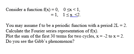

Consider a function
f(x) = 0, 0 ≤ x < 1
and
f(x) = 1, 1 ≤ x < 2
What is the function and how did you find it? Please help it will be used for a Fourier Series project. I can get the Series stuff fine but I just don't remember how to find a function.

csmitty12 said:
The thing is, is that it is supposed to be a periodic function with Period 2. I can't draw it that's all the info I've got.

It is for a Fourier Series project. I can get the FS through MATLAB, my only question is how to get the function to use in the FS?
Oh, that's different (now seeing the actual problem statement). They say to construct a periodic square wave out of that basic function. Do you know how to calculate the Fourier Series of a square wave with a DC offset?

So far we have only learned sinusoidal functions and complex representation. I'm not too sure how do do it with a square wave. Any idea where I can get started?

Okay so now I understand how to get the equation for the series. Now I'm confused and stuck on the part where it says to calculate the first 30 terms for two cycles, x = -2 to 2. Any hints/suggestions?

What happens when you google Gibb's Phenomenon?
