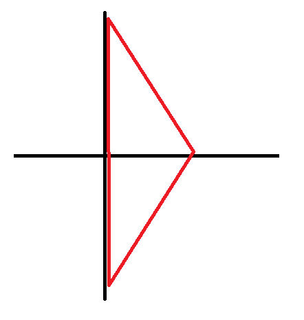

So, I have to find the y-coordinate of the centre of mass, but I'm not sure how to go about doing it... Is integration necessary here? Very confused :(
You're on the right track. Yes, integration is required.
Hint: do it for a 2-dimensional figure.
Hm.. I know this sounds stupid but I'm not really sure *what* to even integrate to get the equation to be in terms of y...
Am I on the right track with this kind of set-up? (I've attached a picture of my 2D diagram)

Whoops... maybe this makes more sense?

Or you could remember what the c.g. of a triangle is from geometry. (Do you work out everything from first principles? That's got to take a lot of time.)
Integration is certainly 1 way to approach this, but since you're given such exact dimensions, why not just take a geometric approach?
For any triangle with a constant, continuous mass distribution, the center of mass is the centroid. The centroid is found by drawing 3 lines, each from one vertex of the triangle to the midpoint of the opposite (non-adjacent) side. The intersection of these 3 centroid lines is the centroid.
So, pretend for now that your triangle is flat (no depth). Using the diagram you drew, assign coordinates to the vertices and use the coordinates to figure out the equations of these 3 centroid lines (you only need to find 2 lines). Then, just find their intersection. That will give you the (x,y) coordinates of the center of mass. To find the z-coordinate, just divide the depth of the triangle in 2.

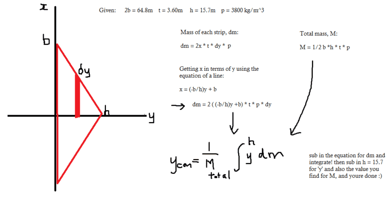

Haha that is certainly a lot simpler! But I'd like to also try with integration just as practice, to since I've never done this before...
I've attached another picture of my progress so far. How is it looking?
I'm a bit lost on where to go from here, and if I'm even on the right track at this point haha.
It looks like I have to get that "x" in my 'mass of each strip' equation in terms of y. Should I be using the 'area of a triangle' equation for this? I'm not sure where else to stick it in...

Update!
I think I did it successfully by the integration method :D
My answer to the original question about energy came out to be 3.21 x 108 J, whereas the textbook answer is 3.57 x 108 J. I think I'm getting decimal place errors since the numbers come out to be so big, or so I'd like to think!
I've added my updated diagram with a general over-view of my steps, just in case anyone wanted to check. Woot! I'm happy :)

Instead: put the base on the x-axis and the opposite vertex at x = 0. Let base = 2a and height = h. Now, the work needed to assemble the monument is the sum of all dm times respective heights, times g. This is an easy integration, and you just have to do half of the triangle. Picking the right part, work lifting an element dx*dy a height y is y*dx*dy (omitting density, g and depth for the moment). So for a sliver dx the work required is ∫ from y = 0 to y = sx+h of ydy where s = -h/a. This computes to (sx + h)^2/2.
Next we integrate the slivers from x = 0 to x = a:
∫ from 0 to a of [(sx + h)^2/2]dx = (s^2)(a^3)/6 + sh(a^2) + a(h^2)
Substituting,
s = -h/a = -15.7/32.4 = -0.4846
a = 32.4
h = 15.7
& the integral computes to 1330.7. Multiply by 2 for the left half of the triangele gives
2661.4
And work is therefore 9.81*2661.4*3.6*3.8e3 = 357162009 J.
Which agrees with your textbook!
I still think finding the c.g is of great interest. I will send you a private message if I work that out, since your post will probably have disappeared from the board by then.
Sudden dawn: the job is done! Let d be the distance of the c.g. above ground, then d = E/mg where E is the total work (3.57e8 J) and m is the mass of the monument.
