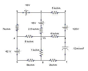

1. Find the current in each resistor and voltage at point Vx
Using Kirchoff's rule and system of equation I found currents but I am not quite sure how to calculate voltage at point Vx. I am pretty sure I got the currents right.
Is it Vx = 1k(I8) ?
or is it Vx = 6k(I3) + 2.5k(I4) + 4k(I6) ?
Uploaded as the attachment
