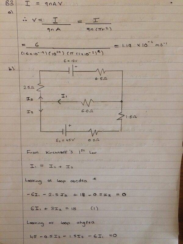

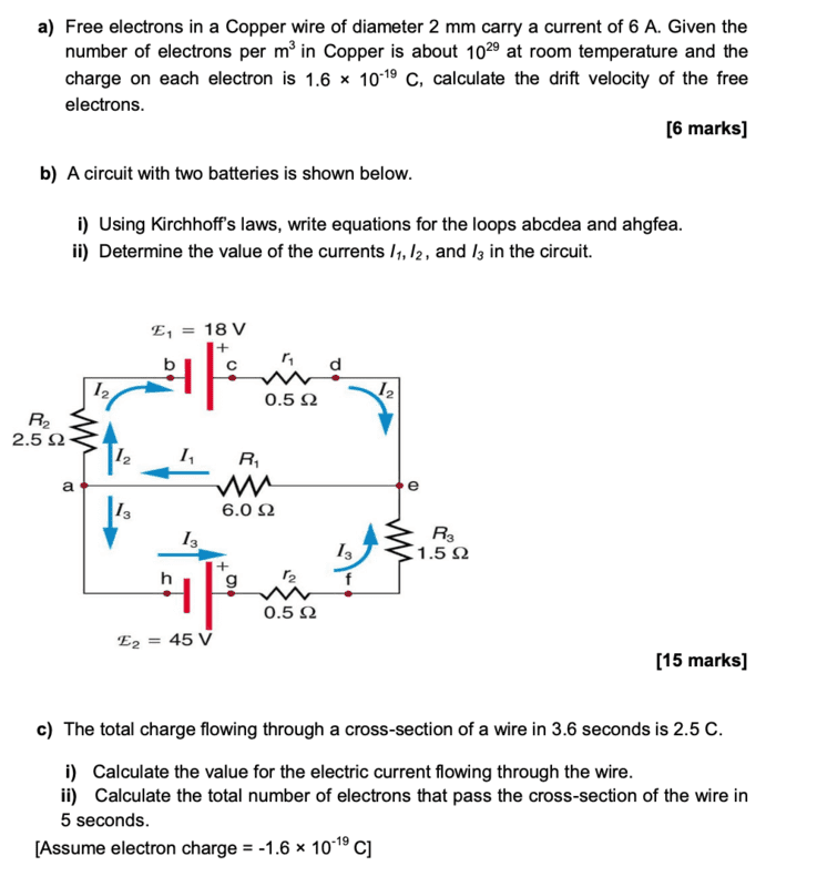

Here is my question that I have been trying to do
Exam question sheet with three parts: a) drift velocity of electrons in a copper wire, b) a two-battery circuit with resistors R1 to R3 and currents I1, I2, I3 labelled, c) charge and current calculations; circuit shows E1 = 18 V, E2 = 45 V, R2 = 2.5 ohm, R1 = 6.0 ohm, r1 and r2 = 0.5 ohm, R3 = 1.5 ohm.
Had tried to attempt it and got there as my answers? Not particularly sure if I had done part b) right from the simultaneous equation I had to solve to get the current values
Handwritten notes on lined paper: part a) drift velocity v = I/(nqA) = I/(nq pi r^2) worked numerically to 1.19 x 10^-4 m/s; part b) a circuit with 18 V and 45 V batteries, resistors 2.5, 0.5, 6.0, 1.5 and 0.5 ohms, and loop equations written beneath.
Handwritten working on lined paper solving two loop current equations by substitution and elimination, giving I3 = 8.25 A and I2 = -3.5 A (opposite to the original direction).
Handwritten working on lined paper: I1 = I2 + I3, then I1 = -3.5 + 8.25 = 4.75 A, hence I1 = 4.75 A, I2 = -3.5 A, I3 = 8.25 A; c)i Q = It, I = Q/t = 2.5/3.6 = 0.694 A; c)ii Q = 2.5/3.6 x 5 = 3.472..., number of electrons = 3.472.../1.6 x 10^-19 = 2.17 x 10^19.
Appreciate for any help! Thanks

Part b) looks fine, I haven't run the numbers for a) and c) but your methods look right.
Part a) and c) both are correct. (I wonder if they really give 6 marks for part a o0))
Thank you both for taking a look at it! Appreciate the help
