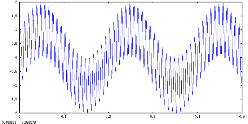

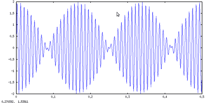

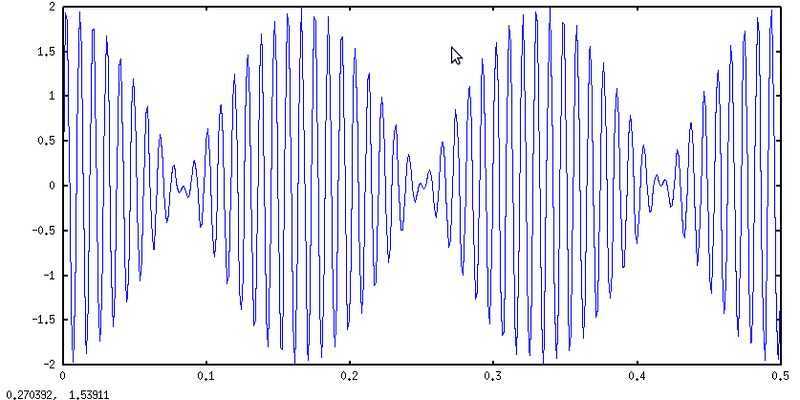

The attached plots are linear-superpositions of sine waves of the form:
\psi = \sin{(2\pi f_1)}+\sin{(2\pi f_2)}
... f1=110Hz and f2=104hz ... shows beats.
... f1=110Hz and f2=5hz ... shows the signal modulation.
Thanks for the plots. They are exactly as expected.
For a signal V(t) = cos(2pif1t) + cos(2pif2t) the expression is
V(t) = {2cos2pi[(f1-f2)/2]t}*cos2pi[(f1+f2)/2]t
where the beat frequency is contained in the term before the * sign and the average "carrier" is the term after the * sign. Note that the beat frequency is half the difference of the two beating frequencies, not the difference itself. The "carrier" is the avergarge of the two beating frequencies. As I said, the term "carrier" is really inappropriate since there is no carrier carrying a modulating signal.

The second plot is more like what OP has.

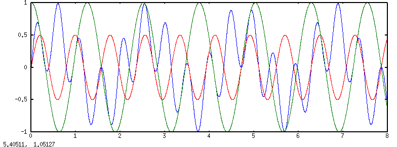

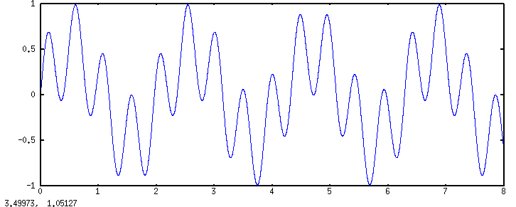

I suspect this is what you are talking about:
The example: x=4\cos(5t)\sin(8t), if I took the "like beats" description literally I's think of the cosine factor as the "envelope" (beat frequency 10rad/s) and the sine factor as the "tone". But if I plot them I get:
... where the blue is the waveform, the green is the cosine term and the red is half the sine term.
Clearly the green line cannot be seen as an "envelope" of anything - it's nonsence. Yet the math is consistent.

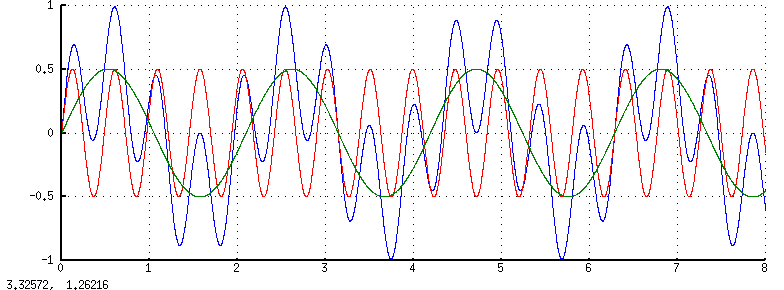

If I separate the waveform into components, the situation is clearer.
... here the blue is still the waveform, the green line is the slow term and the red one is the fast term.
Notice the amplitudes are (sort of) half the waveform's?
I artificially halved the amplitude of the red wave in the first plot to make it clearer - but this time I left everything.
We'd tend to think of the green one as the carrier wave and the red one as the signal - though there is no special reason it cannot be the other way around. In fact the situation in the problem is ambiguous: we are not told this is for radio or an electric circuit of any kind. It could be a cork bobbing on water - in which case the roles of carrier and signal make no sense. It's just sometimes useful to have something to visualize.
