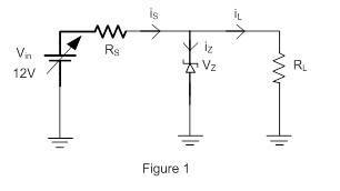

I don't know how can i find the Iz and Is.
The zener voltage VZ = 7.2V, with the condition that the zener current 77mA ≤ iZ ≤ 1A
load resistance RL = 10Ω.
What is resistance RS when load voltage VL is regulated to 7.2V while the input voltage Vin varies by ±10% from its nominal value of 12V. Also check that the zener current iZ is larger than 77mA at lowest input voltage Vin .
Redraw the circuit for Vin = 12V - 10%, this time marking on every parameter you know. Post that labelled schematic.
Is this HW?
IL = Vz/RL
Is = Iz +IL
Rs = (Vin - Vz)/Is
