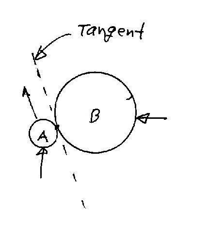

First assume that B is stationary and A hits B at say the 8:30 position. A will be deflected to the West but continuing mostly North. If B is moving West, the colision at 8:30 should push B in the North direction also. See my figure.
And how did A get through the bulge of B to go in that direction?
I stress - draw the common tangent at the point of collision. Each sphere has to stay on their respective sides of that common tangent - unless they can somehow travel through each other.
I'm not seeing it. Would you not agree that if B is stationary, locked into position and if A hits B at 8:30, would not A move north and slightly west after the glancing blow?
Now if B were to be moving at a slow velocity west when struck by A, would not B be nudged slightly to the north as A deflects off of it?
I am not sure about your tangent point. If I draw a tangent at the point of impact, it seems that both masses will deflect at the point of tangent but I don't see the problem? I have attached a clearer diagram, I hope.
The numbers seem to work out unless I made a calculation error.
It is early in the morning here and maybe my brain is still sleeping.
The problem is if they both deflect away from the impact tangent line. That has mass B traveling to the right, rather than the left, of A.
If the mass of B is so large as to not deflect much - and follow the 160o direction, A will be deflected below that direction - perhaps even South of West.
if the particles are spherical, A cannot get around the edge of B to travel in a more Northerly direction than B.
I may be dense but I still don't agree with you as yet. If A hit B at say the 7 o'clock position of B, then I would agree that A would travel South West and B would be deflected north. But let's take an extreme case where B is large and moving very very slowly and that A strikes B at the 8:59 position of B. Surely you would agree that A would be deflected only slightly west of north. B would experience a slight bump in the northly direction as A hit it and would be slightly deflected to say WNW
I worked the numbers using conservation of momentum and got answers. However when I used the answers I got to see if KE was conserved, it wasn't. SO, you are probably correct and I need to rethink the problem. Bummer, I was hoping for a victory here :-)
