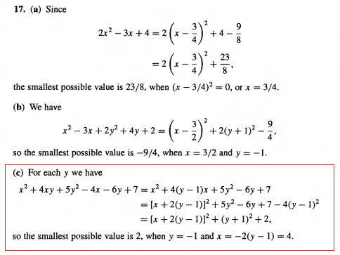

LCKurtz said:
That doesn't look like a "minimum value" of anything. Please give the exact wording of the problem from your text.
Here is the problem from the book(part (c) in the red rectangle):
Printed textbook problem 17 with parts (a) to (c): (a) find the smallest value of 2x² - 3x + 4, hint complete the square; (b) find the smallest value of x² - 3x + 2y² + 4y + 2; (c) find the smallest value of x² + 4xy + 5y² - 4x - 6y + 7, boxed in red.
Here is the solution of (c) from the answer book(again surrounded in red):
Worked solution in a textbook answer key: parts 17(a) and 17(b) complete the square for quadratics, and part 17(c) completes the square in x for x^2 + 4xy + 5y^2 - 4x - 6y + 7, giving a minimum value of 2 at y = -1 and x = -2(y - 1) = 4.
