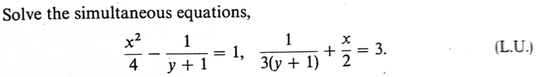

Solve the given simultaneous equations in x^2, x and y
  • Thread starter Thread starter chwala
chwala
2,844
434
See attached
Simultaneous equations
In my approach i have,
##\dfrac{x^2}{4} -1 = \dfrac{1}{y+1}##
##9-\dfrac{3}{2}=\dfrac{1}{y+1}##
then,
##\dfrac{x^2}{4} -1= 9-\dfrac{3}{2}##
##x^2-4=36-6x##
##x^2+6x-40=0##
##x_1=4, x_2=-10##
it follows that when ##x=4## then ##y+1=\dfrac{1}{3}## ⇒##y=-\dfrac{2}{3}##
and when ##x=-10## then ##y+1=\dfrac{1}{24}## ⇒##y=-\dfrac{23}{24}##
Seeking alternative ways...
I see no reason to hope there is a quicker way. Btw, you seem to have dropped 'x' in a couple of places when typing your post.
