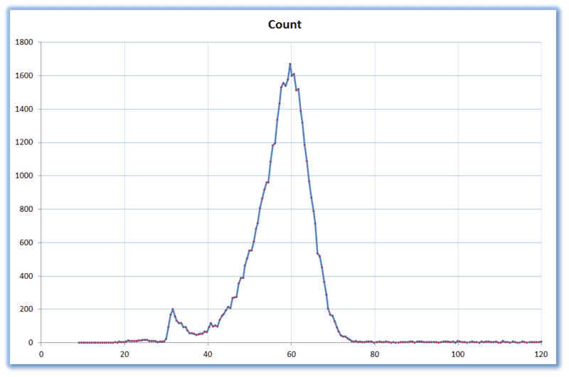

At the end of the measurement I made with a detector, I only have the energy and count values as in the attached excel file. How can I find the peak values with the data I have and calculate the efficiency?

Peak values ? Do you mean 1670 and 202 :wink: ? If not, you have to describe more clearly what you mean ...
Efficiency is something like 'found'/'total' and can not be determined from 'found' alone.
So more info is needed...
By the way, it seems to me that your 'energy' is a calculated value, so a histogram would be more appropriate than my XL?:)xy plot. Right ?

If I have to guess (again ! -- csv file name and some googling :rolleyes: ) you are looking at the gamma spectrum of 241Am decay . There is a peak at about 60 keV and something more at around 30 keV -- but in comparison with some googled spectra (e.g. this) there is a reduced sensitivity of your detector setup there.
In addition your detector has a certain resolution that causes a peak with some width. You can add up all counts from 40 to 75 keV or do a fit to an asssumed peak shape to estimate a counting rate at the 60 keV peak. Not trivial.

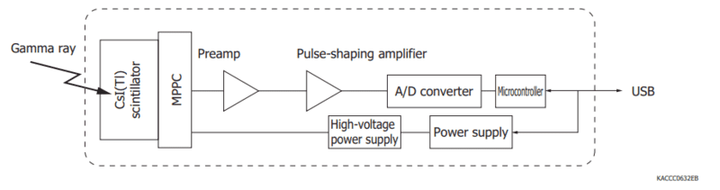

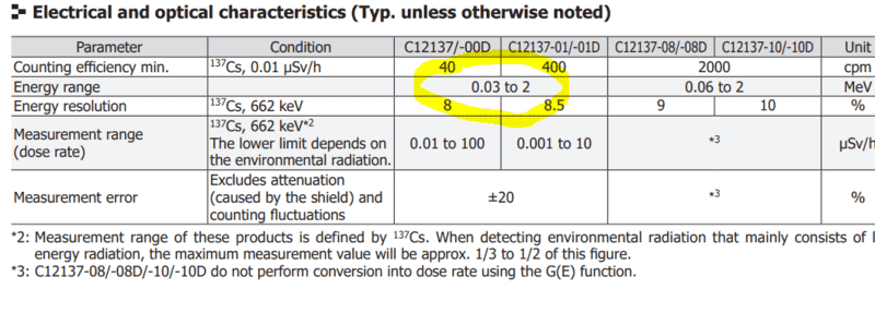

From the link I see a possible explanation of the 30 keV situation:
and of the peak width at 60 keV.
