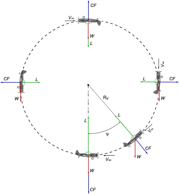

@aadityav, to clarify your teacher’s intent, you could ask them this:
Planet A has a surface gravitational field strength of 51 m/s##^2##.
Planet B has a surface gravitational field strength of 61 m/s##^2##.
Planet C has a surface gravitational field strength of 71 m/s##^2##.
On which planet(s) would the seated/stationary pilot lose consciousness?

There is another way of looking at this. First let's ask why the pilot loses consciousness. I would say that if he accelerates up with acceleration ##a## relative to the ground, the hydrostatic pressure between his heart and brain that is normally ##p=\rho g\Delta h## would now be ##p_a=\rho g_{\text{eff.}}\Delta h## where ##g_{\text{eff.}} =g+a##.
(##\Delta h## is the height difference between heart and brain.)
We are told that when ##a=6g##, the pilot passes out, presumably because the heart is unable to provide the requisite oxygenated blood supply to the brain. From this we conclude that the pilot passes out when his apparent weight is ##W_{\text{app.}}=mg_{\text{eff.}}=7mg.##
A free body diagram shows that the apparent weight is the normal force ##N## exerted by the seat on the pilot, $$W_{\text{app.}}=N=mg+\frac{mv^2}{R}.$$ Note: @Steve4Physics posted as I was composing this post but I decided to finish anyway.

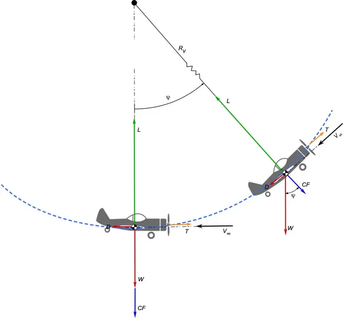

aadityav said:
So the correct answer would be when I set CA=6g, right? And I would not include the force due to lift, right? Thank you!
The value of the increased lift force at the bottom of the loop is the only net force that induces the airplane to deviate from a level horizontal flight.
In order to describe a perfect vertical circle, any aerobatic pilot must change the generated lift along the circle via more or less gradual angle of attack of the wing via deflection of the elevator.
In order for the airplane to have and upwards acceleration of 6g at that lowest point and horizontal attitude, the wing must generate a lifting force equivalent to 7g.
As previously explained, the value of the lift force must be gradually reduced after that point, or the radius will become smaller.
