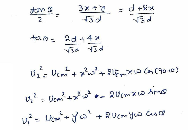

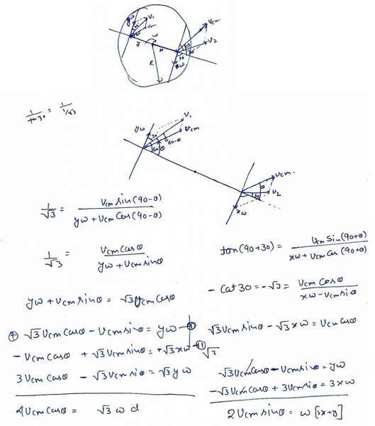

Hi friend I am really getting big problem in solving this question which is related to Rotational dynamics. Please help me in solving this. I will be heartily thankful to u all guys.
The question is as follows :
https://fbcdn-sphotos-f-a.akamaihd.net/hphotos-ak-ash3/549594_2636991701343_1266262284_n.jpg
I am always getting the answer as Option (a) But the answer of this question is (d).
I am attaching all the attempts as an jepg image along with it. Please friends go through it and Please help me.
  • Handwritten working on a rotational dynamics problem: a circle with a rod-like line and velocity vectors labelled Vcm, Vi and VL, followed by trigonometric equations such as tan(90+30) and sqrt(3) Vcm cos theta, leading to 2 Vcm sin theta = omega(x+a).

  • Handwritten working: tan(theta/2) = (3x+y)/(sqrt(3)d) = (d+2x)/(sqrt(3)d), then tan theta = 2d/(sqrt(3)d) + 4x/(sqrt(3)d), followed by velocity-squared expressions v2^2 = vcm^2 + x^2 w^2 + 2 vcm x w cos(90+theta) and v1^2 = vcm^2 + y^2 w^2 + 2 vcm y w cos theta.
The axis of rotation is not located at the middle of the disc. This can be seen from the fact that the velocities are not perpendicular to a line drawn from the centre of the disc. Use the fact that the speeds are tangential to the circular paths that A and B follow about the axis of rotation to locate the position of the axis of rotation.
