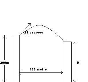

I've been trying to do this question for ages, but I just can't seem to figure it out. I can't find the height of the second building.
Question:
A bag of mail is catapulted from the top of a building 200 m above the ground with a velocity of 20 m/s at an angle of 15 degrees above the horizontal. If the mail is to land on the roof of another building 100 m away, how tall is the second building?

This should make things clearer. How do you think the given information helps??
I can't open the attachment. Sorry I'm new here so i really don't know things work.
It says the attachment is pending an approval. Ill just wait.
I'm going to be honest. I kinda had that same diagram drawn out. I still can't draw out an equation to find out how tall the second building is.
Okay, you have that picture.
Say that the origin of your coordinate system is at (0,0), so that the initial height is at (0,200) and the final is (100,H).
[tex]\vec{r}=\vec{r}_{0} + \vec{v}_{0}t + \frac{\vec{a}t^{2}}{2}[/tex]
I suspect you've seen this equation before. Split it into the y- and x-coordinates, and try to use the coordinates I wrote out earlier.

It's catapulted at 20m/s at an angle of 15°
So you know your horizontal velocity from θ. Dividing that into the horizontal distance of 100m gives the minimum flight time and from that you can determine the minimum height differential between the buildings. (You also know your vertical Vy from θ as well.)
ΔH = Vy*t - 1/2*g*t2
I tried LowlyPion's method and i got the answer correct. It was only a matter of using the same time for the vertical equation to get the answer. Thanks a lot. I really appreciate everyone's help
