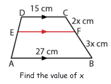

Finding the length of this side of similar figures

Please see below
Similarity
Is it possible to find the value of ##x##? I feel like the information is not enough to find it.
I have found EF, which is 19.8 cm (if this is helpful)
Thanks

You can't find ##x## from the information given.

If you made a "3,4, 5" right triangle with 5x as the hypotenuse, you could get closer to a solution.
Sorry I don't understand. I think what you suggest is related to ratio, not to actual length, or am I mistaken?
Thanks
It seems to me that you could make up any value for ##x##, e.g. 3, and then find that some other value, e.g. 5, would work just as well.
