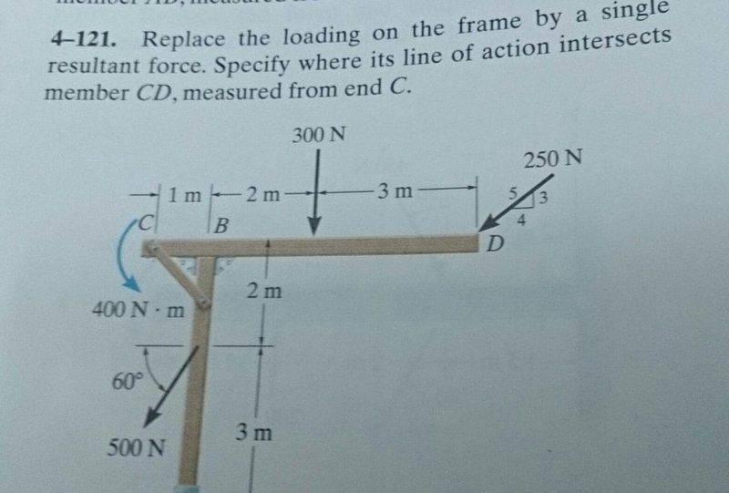

I'm having problem of finding the point where the line of action intersect with CD , hot to do it ?
Fx = -500cos60 - 250(4/5)
Fy = 300 + 500sin60 + 250(3/5)
FR = 991N

What can you say about moments?
moment = rF r = perpendicular distance from the force... Is there any shortcut to do this question ? or just keep on trial and error until get the correct ans ??
No, I mean what is the relationship between the moments of the forces and torque in the diagram about C and the moment of the equivalent force?
