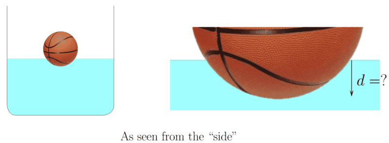

A basketball of mass 600 g and radius 12 cm floats at rest on the surface of water. Calculate the depth ##\boldsymbol{d}## of the ball that's under the liquid surface.
(1) Law of floatation : The mass of a floating body is the mass of liquid displaced - ##m_B=\Delta m_L##.

I make a sketch of the problem situation. I need to find the depth inside water ##d=?##

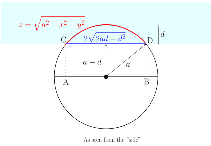

If I "overturn" the basketball and looking from the "side", call its radius as ##a##, I would have an image like the one alongside. The red arc ##\color{red}{\stackrel{\large{\frown}}{CD}}## is the 2-D surface of the ball inside water whose ##(x,y,z)## coordinates at any point are related by ##z=\sqrt{a^2-x^2-y^2}##. The blue line ##\color{blue}{\overline{CD}}## marks the boundary of the region under water. Using the Pythagorean theorem, the length of the line ##{\color{blue}{\overline{CD}}}\text{AB}## is ##2\sqrt{2ad-d^2}##. We understand that this line ##{\color{blue}{\overline{CD}}}\text{AB}## is the diameter of the circle at the boundary of liquid.
Hence the volume of the region under water is the difference of the volume of region ##{\color{red}{\stackrel{\large{\frown}}{CD}}}\text{AB}## and ##{\color{blue}{\overline{CD}}}\text{AB}##.

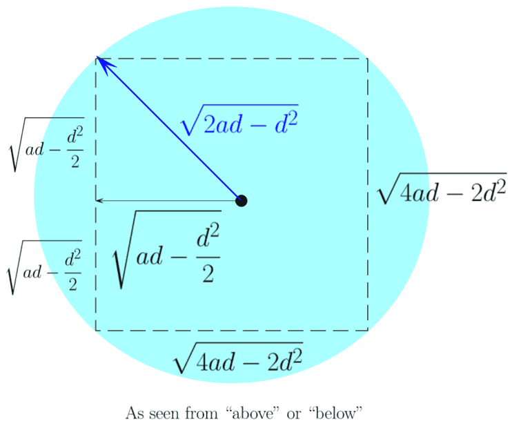

The volume of the region ##{\color{blue}{\overline{CD}}}\text{AB}## is easy. It is a cuboid with a square on "top" of dimensions ##\sqrt{4ad-2d^2}##, calculated upon use of the Pythagorean theorem to find the side of a square given its radius (= ##\sqrt{2ad-d^2}##). The height of the cudoid (as seen from the "side") is ##(a-d)##. Hence the volume of the cuboid ##{\color{blue}{\overline{CD}}}\text{AB}## is : ##V_{\text{cuboid}}=2(2ad-d^2)(a-d)##.
But now to find the volume of the region ##{\color{red}{\stackrel{\large{\frown}}{CD}}}\text{AB}## whose upper serface is a portion of a sphere?
This is where am stuck. I am aware that the equation of the upper surface ##\color{red}{\stackrel{\large{\frown}}{CD}}## is ##\color{red}{z=\sqrt{a^2-x^2-y^2}}##. The lower surface of the same region is a square of dimensions ##\sqrt{4ad-2d^2}##. But how to find its volume?

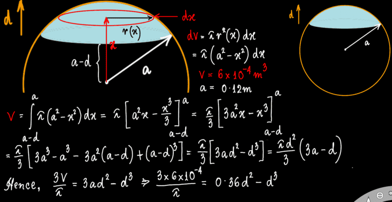

Divide the submerged region into horizontal discs. If the ball has radius r and a disc thickness dx is distance x from the ball's centre, what, approximately, is its volume?

Yes, I can do the problem that way. I do it below roughly writing into ##\text{Sketchbook}^{\circledR}## and hope it's readable.
We end up with a cubic equation we have to solve to find ##d## : ##d^3-0.36d^2-5.73\times 10^{-4}=0##.
Since I don't know how to solve it, let me try online.
The answer comes out to be : ##\boxed{d = 4.2\;\text{cm}}##.

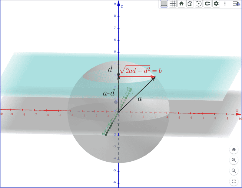

I am afraid to bring you back @haruspex to the (unsolved) problem above of finding the volume of the spherical cap , at least the way I'd want it. Forget the numerical details for now.
The goal : ##\textbf{To calculate the volume of the spherical dome using the method of calculus.}##
Now I succeeded in doing that using the method you said in post #2, using thin discs of thickness ##dx## at distances of (increasing) ##x## from the sphere's center. The answer came out to be ##\boxed{V = \dfrac{\pi d^2}{3}(\underline{3}a-d)}\qquad (1)##. I underline the 3 for a reason that will be apparent soon.
