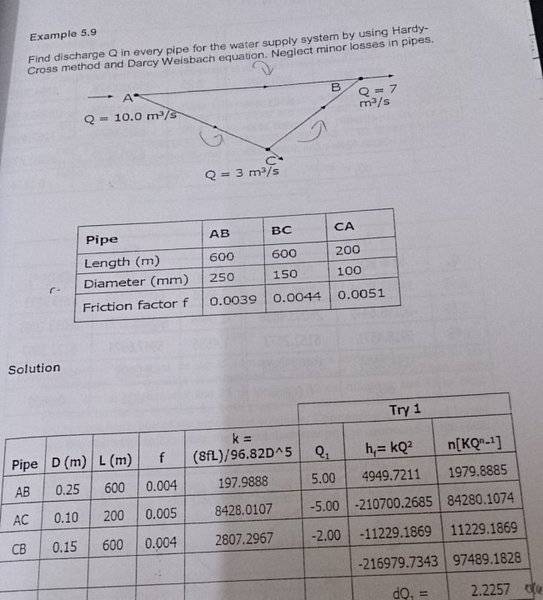

why the Q1 for AB is 5 ? for Ac is -5 , while for CB is -2 ? how to determine them ?
I could only see Qat A = 10.0 , Q at C = 3 , Q at B = 7
P/ s: the author take clockiwse direction to be positive , anticlockwise direction to be negative ...

is the author wrong ?
It's only a trial solution. Any values could have been used that add up correctly.

what do you mean by trial solution ? I'm confused... how did the author get the Q= 5, -5 , and -2 based on 10 , 3 and 7 ?

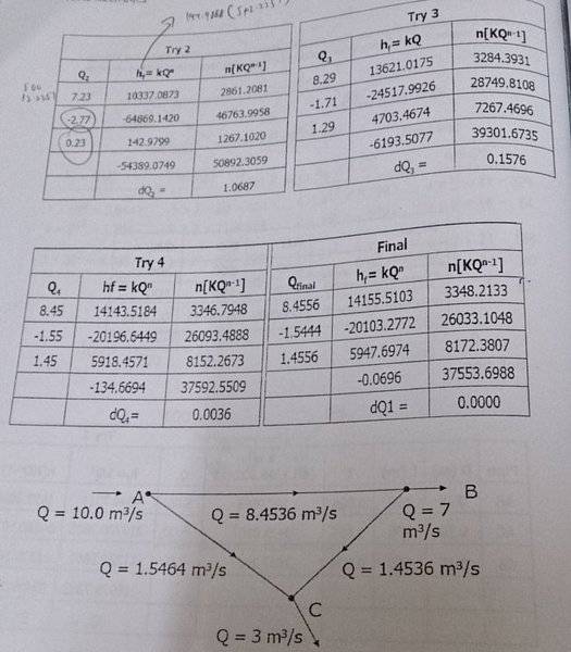

I mean it is just an initial guess, consistent with the 10, 3 and 7. The method goes through an iteration to get closer to the actual solution. As an exercise, you could start with 6, -4 and -1 instead and check that you end up with the same final answer.

is there any rule to choose the 3 numbers for initial guess? e.g , if i choose the first number is 15 , will it affect the second and third number that i am choosing ? or it is just guessing ?
