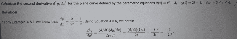

Worked solution: second derivative d²y/dx² for x = t² − 3, y = 2t − 1, showing dy/dx = 2/(2t) = 1/t, then (d/dt)(dy/dx) divided by dx/dt, reducing to −t⁻² / 2t = 1/(2t³).
ok this is pretty straightforward to me, my question is on the order of differentiation, i know that:
##\frac {d^2y}{dx^2}=####\frac {d}{dt}.####\frac {dy}{dx}.####\frac {dt}{dx}##
is it correct to have,
##\frac {d^2y}{dx^2}=####\frac {d}{dt}##.##\frac {dt}{dx}##.##\frac {dy}{dx}##?
that is,
##\frac {d^2y}{dx^2}=####\frac {d}{dt}####\frac {dy}{dx}####\frac {dt}{dx}##=[##\frac {d}{dt}####.\frac {1}{2t}##]##\frac {1}{t}##
does the order really matter?
I already checked. I realize the same result...just wanted to know if the steps is accepted mathematically...
i am wrong...i just checked with another example

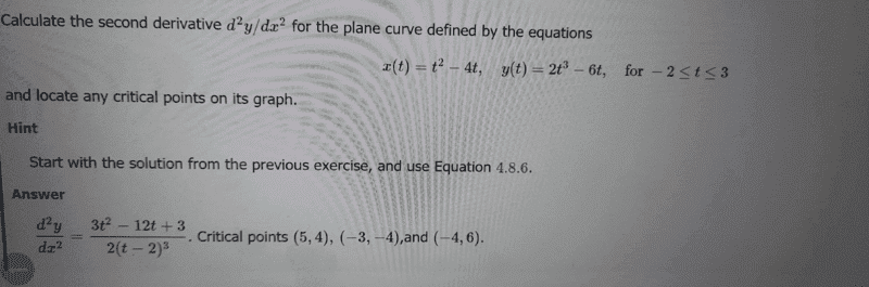

Textbook screenshot: calculate d2y/dx2 for the parametric curve x(t) = t^2 - 4t, y(t) = 2t^3 - 6t for -2 ≤ t ≤ 3, with a hint and answer d2y/dx2 = (3t^2 - 12t + 3)/(2(t - 2)^3), critical points (5, 4), (-3, -4), (-4, 6).
the order does matter...
thanks anuttarasammyak:cool:
How did they find the critical point##(-4,6)##? in post ##4##, for the other two i.e ##(5,4)## and ##(-3,-4)## its pretty straightforward ...we use ##t=1## and ##t=-1##.
on my attempt of the other critical value, i used;
##t=2##, this should also give us a critical value because it is undefined at this point and therefore we ought to have critical point ##(-4,4)## and not ##(-4,6)## as shown on text. someone clarify this...
It seems to depend on how your textbook is defining "critical points".
(5,4) and (-3,-4) are stationary points where maximum and minimum of y are observed.
(-4,6) is stationary point where minimum of x is observed.
(-4,6) is stationary point where maximum of x is observed.
why ##(x,y)=(-4,6)##? and not ##(-4,4)##...my interest is on the ##y## value, why ##y=6## and not ##y=4##?

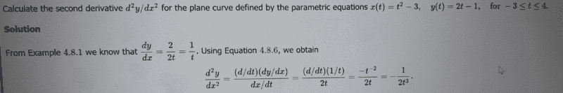

we are seeking to find the second derivative and have already found the values of,
##\frac{dy}{dx}## and ##\frac{dx}{dt}##, now to find the desired second derivative, i think its just a straightforward method, like I've indicated...no need for further chain rule or product rule...
This is straight to the point,
##(\frac {d}{dt}## of ##\frac {dy}{dx})##times ##\frac {dt}{dx}##... same as the textbook suggests as in my post ##1## above.
