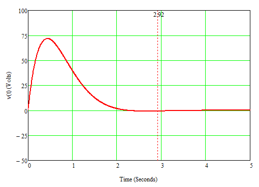

Lat's take a look at the plots of the voltage vs time. First the "big picture" where we can see the whole response curve over 5 seconds:
243938
Using features of the plotting software (Mathcad in this case) I find that the maximum voltage is about 71.8 V.

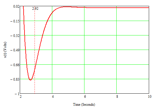

Not much detail available for the time around the supposed settling time of t = 2.92 s. So let's do another plot to zoom in on the action. Note that the x-axis is expanded and the y-axis compressed for this view:
243939
Looks like the voltage at 2.92 s is about 1% (in magnitude) of the maximum voltage response of about 71.8 V of the peak around 0.453 s on the "big picture" plot. It doesn't appear that it can exceed this value in any subsequent oscillations.
So this is an "analog" approach to solving the problem using math software (Mathcad in this case).
