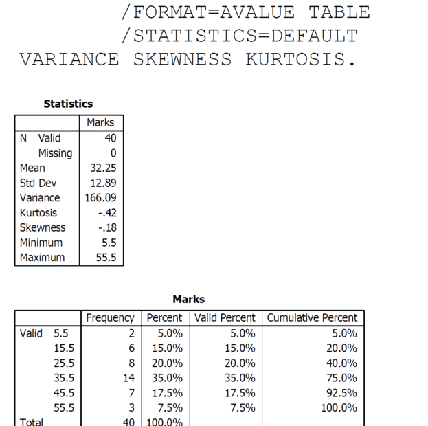

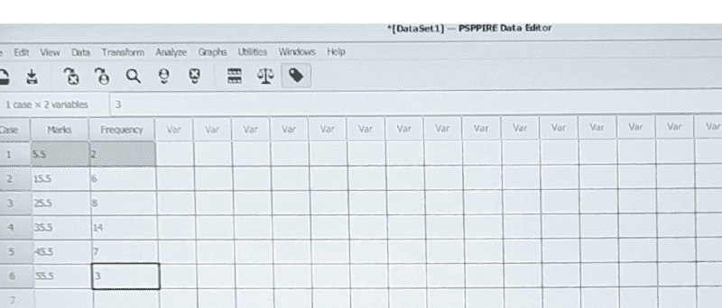

Ok i will check on that...on a side note am trying to also self learn spss; i tried to feed the information as per the table below;
and the results were as follows;
looks like my calculation of skewness was on point.
Well, the same to 2 sig figs (which may be perfectly adequate for your purposes). There are several slightly different formulas for sample skewness (see the Wikipedia article on skewness) and yours is not identical to any of them. It says that the one it calls G1 is the one used in SPSS, and I calculate its value as -0.1824 - very similar to yours but not identical.

But checking this with spss, i am getting ##K= -##0.42##,
where could the mistake be?

Skewness: I think this comes from using your formula with the correct value of S. As I said, your formula is not the same as that used by SPSS; the fact that you previously got (using your formula with the wrong value of S) the same value as SPSS (to 2 sig figs at least) was a coincidence.
Kurtosis: again there are several definitions. See wikipedia page; the quantity used by SPSS is the one they call G2. (You could also check the help for the KURT function in Excel.) Note that this is a formula for excess kurtosis = kurtosis - 3. In your second method, note that m = (n-1)s2, so your formula is a factor of (n-1) too small. (By the way, too many n's meaning different things!)

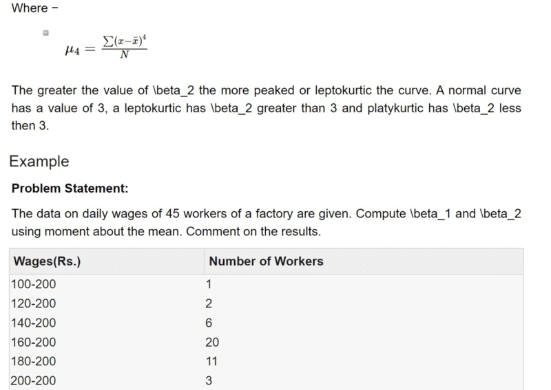

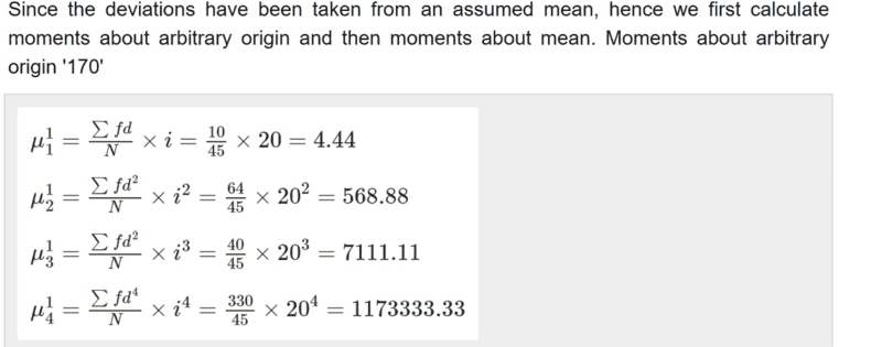

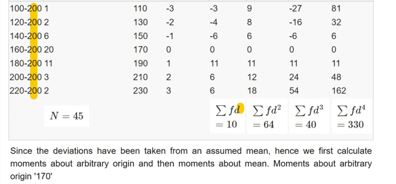

I have read on a better way of finding or rather measuring kurtosis and skewness. This is by using moments...quite straightforward. I need clarity on the highlighted part...
In general,
##d##=##\frac {(ΔMid-point)}{20}##
Now, we need to establish ##d## values from the class intervals. My point is that the textbook has a mistake on the highlighted part of the class interval...it ought to be, ##100- 120, 120-140, 140-160##... this is the part that i need clarity on, otherwise the other steps of the working are clear. i.e...
Therefore,

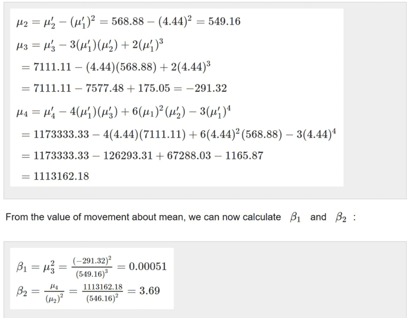

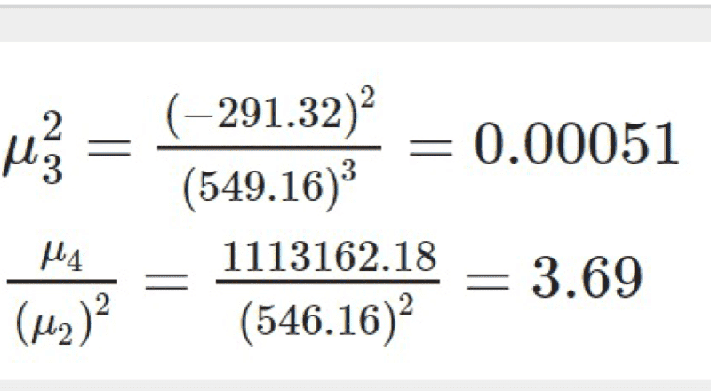

##β_1## and ##β_2## =
implying a 'symmetrical distribution' as the skewness is almost zero and a leptokurtic distribution.
I think the errors are typo...
in the last part, we should have;
##β_1##=##\frac{(μ_3)^2}{(μ_2)^2}##...
