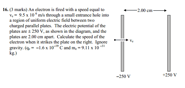

Ok here is the question: Image below:
Physics problem diagram: two vertical parallel plates 2.00 cm apart, the left plate at -250 V and the right plate at +250 V, with an electron entering through a small hole in the left plate with speed ve.
Now the correct answer is: 1.63 x 10^7 m/s

So will the electron be speeding up or slowing down after it enters the Electric field.
Note: the problem is about an electron, but your title mentions "a proton question"?
